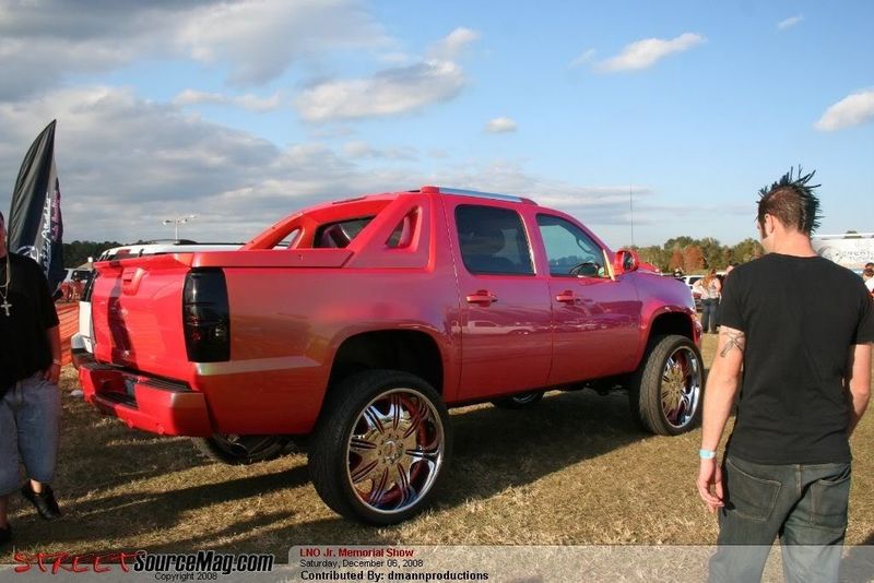

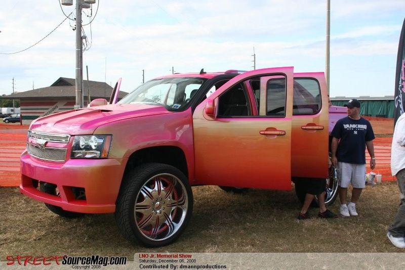

we have  been looking for colors for my girls car and we found one but not sure who makes it and whats its called...and what prices range it its can anyone tell me please...and whats the easyest way to post [ics with out resizing them for the incertpic icon

custom mix, prob pink base with a color shift kandy on top. ugly at that.

agree 100%

looks like pink base with a color shift illusion gold/copper on top. And yes that is ugly as hell. Plus would be about 3k just for material.

Hi all.  Its hard to tell from a monitor but that color looks alot like P.P.G. DH 991 magenta to gold. Its from the Harlequin line P.P.G. has. I dont think its a three stage paint but still very expensive(more of a color change paint than a pearl over a base color). If that color is not it, it is very close. Go to your local P.P.G. paint store and ask if they have a Harlequin chip book because the one I am looking at looks spot on and yes it is UGLY.
