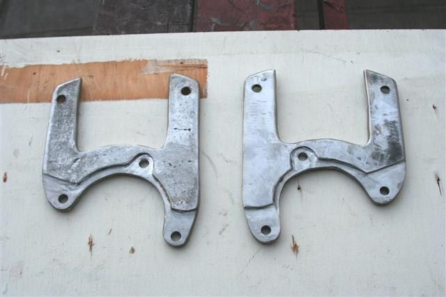

Got the rear disk install completed ,just have to dial in the  brake adjustment

looks good, what kit is that?

Not a kit,same set up Seth did,my own brackets & drilled /slotted rotors from braketplanet.com.their 11.32" / .95" thickness,$97.56 The calipers are GM 79-85 Caddy,from classicperformanceproducts.com,$136 ,load, these have a e-brake. I'm using Lokar cable kit EC-80FU,$209 from E-Bay Here's the brackets I made from 3/8" plate & machined down the caiper mounting ears to 1/4" & 1/8" @ the flange side

looks good. i like it.

very nice

Looks very nice. Not a bad price.
