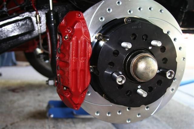

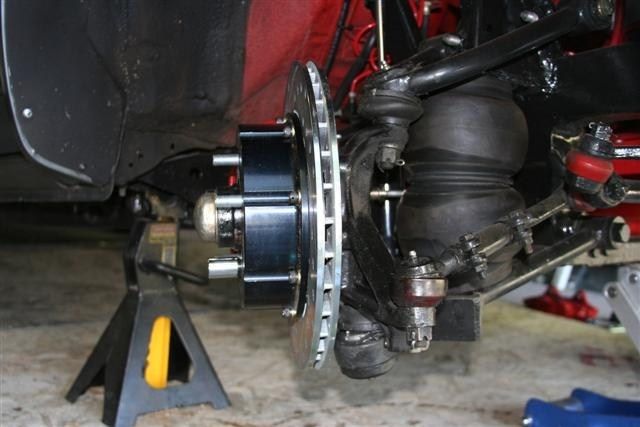

truck action's avatar
truck action
Edited: 1/22/2009 12:40:11 PM by truck action
Edited: 1/22/2009 12:39:03 PM by truck actionI did  the front brake upgrade posted on Toyota Minis. ,on my 88, brakes are much better & look great!This is a Wiwood 12.19" rotor & a Toyota 4-Runner 4-piston caliper. The brackets I got from a guy @ Toyota Minis site

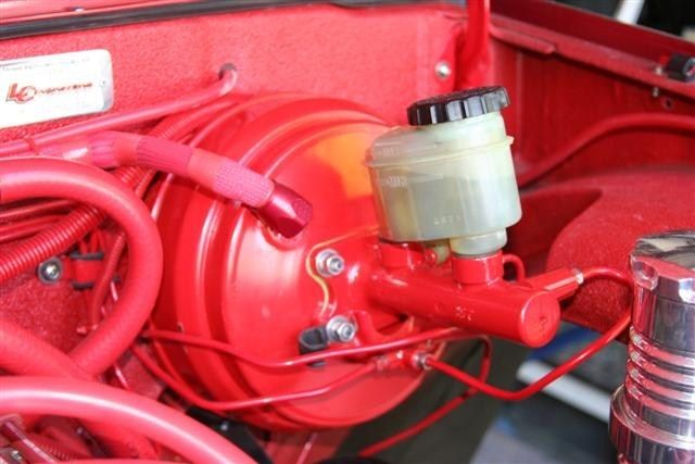

truck action
I also changed the master to a 1" unit & the booster to a duel type
standardbyker88's avatar
standardbyker88
that looks good. i like. ill probably just run a slotted stock replacement for the 89-95s but i do have those calipers. and ive got a 6.5" chevy luv master/booster.
