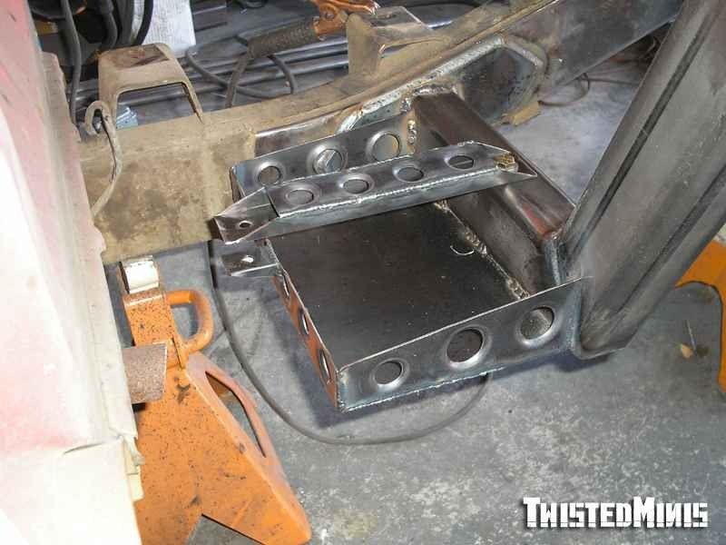

Anybody have any pictures of frames with their battery in the rear. I am thinking about moving mine to the rear of my truck to clean up the engine bay a little. Any help is appreciated.

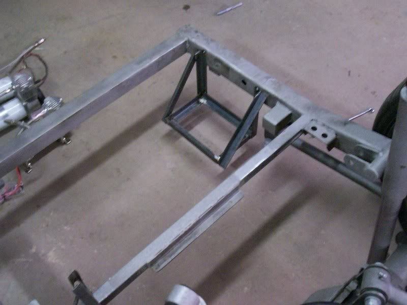

here's one we did. i'll look for more pics later.

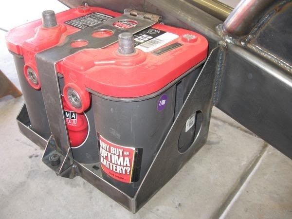

heres where mine is
