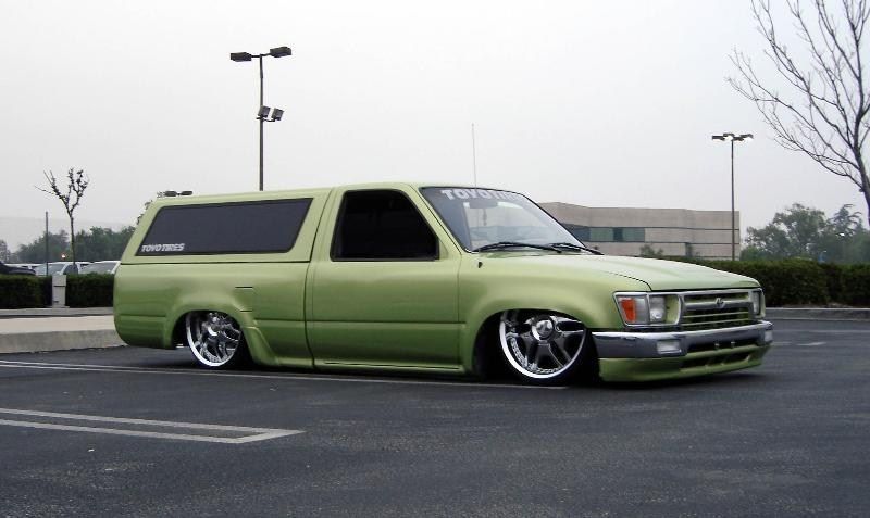

so what size tires are on the green yota above>>> with out cutting anything are you running custom control arms ??
FXDGRND's avatar
FXDGRND

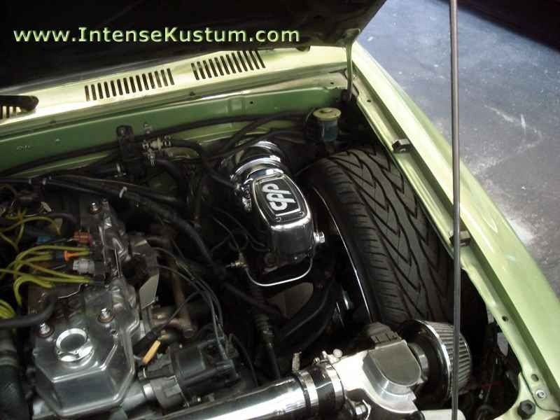

215/30/20 on an 8" wheel.There's alot of firewall and front suspension reworking to get it to sit. The upper arms are tubular KW and the lowers are modified stocks, mainly for triangulation. It has a 2.25 BD with the front crossmember cut down so 'sits like a 3".
Shows the lower reinforcemnets
Shows the intial fitting the 20's
