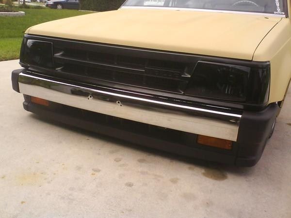

Anyone?  Like what year ranger lights are you using?
h2omelon(nick)'s avatar
h2omelon(nick)
01-06 Ranger headlights
dragamazdog's avatar
dragamazdog
22001 ranger headlights all blacked out just have to use high beams for night driveing
slammedmazda's avatar
slammedmazda
So did you have to fab up some brackets to mount them? And i take it you cut the grill a little?   Thanks for the info! Im off the check out ebay for some lights!!
h2omelon(nick)
The grille has to be cut and the core support has to be trimmed a little.As far as mounting them we used the stock adjuster bolts on the ranger headlights. Just remove the plastic pieces off the adjuster bolts and get some nuts and washers.Then drill holes and mount them up.Once you cut the grille you can use it to get proper placement.
slammedmazda
Thanks Nick!
slammedmazda
Hey Nick, Are you useing the mazda wiring to the headlights? Or did you use the wireing from the ranger?    Sorry for all the questions!
h2omelon(nick)
I got the plugs from a ranger in the salvage yard and wired them int the mazda wiring.
