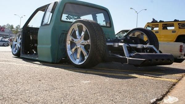

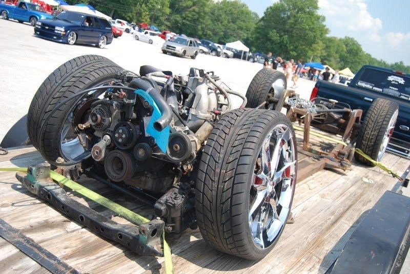

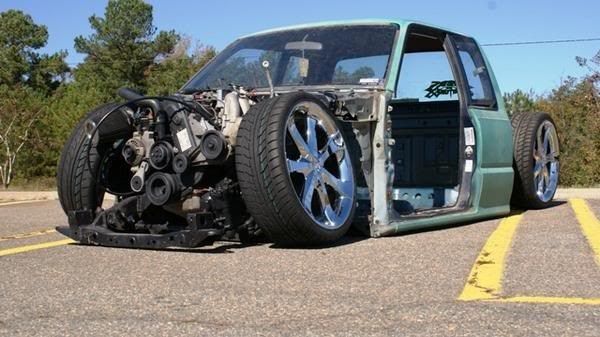

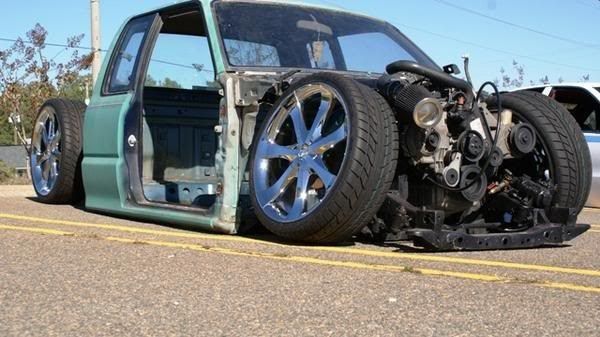

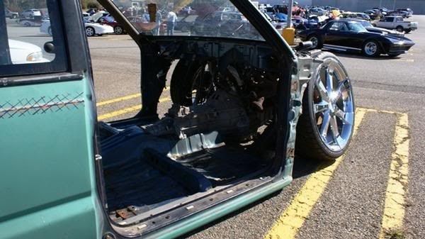

so we cut on it til 1 this morning and drug it out to its first show, a memorial show we did for one of our members, so here are some daytime pics.
jealousonezenvy's avatar
jealousonezenvy

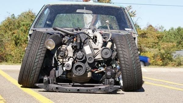

What did you all do to tuck these rims? like what control arms and front frame mods did you do? also what did you do to the rearend or what rearend you using?
SmplDsgnBlazer's avatar
SmplDsgnBlazer
the truck has all 4wd sheetmetal, including the bed. it has toyota front hubs and toyota rearend. the upper and lower control arms are stock mazda and stock toyota spindles. with the wheels being a +35mm offset, they'e basically like a fwd wheel. therefore they sit really close to the frame, avoiding fender clearance issues.

the only thing done to the control arms is the uppers were pie cut, sectioned, and the balljoints moved so they didnt bind up when the truck cambered while laying out. the lowers are stock, not modified. and the spindles are stock toyota spindles, not modified.
