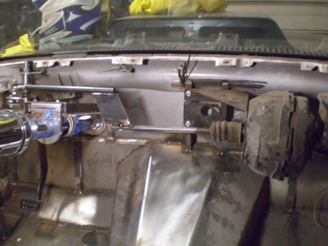

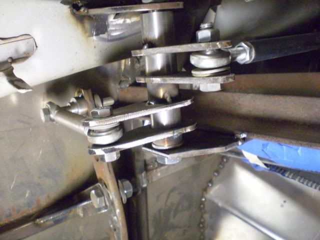

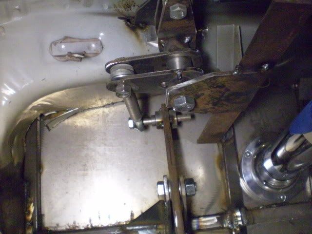

I made my own, and I fill it up through the glove box...
The tricky part is to get the correct petal travel to rhe correct master cylinder travel. I had the bracket for the Dodge van, but the room I had to work with, it just didn't work. Here is what the van assy. looked like.

Thanks for all the info! Is that from a fullsize Dodge van? Justin, how did you calculate pedal ratio? I like the setup you built. I may have to do something like that on mine.
