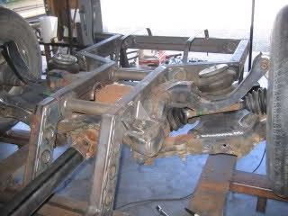

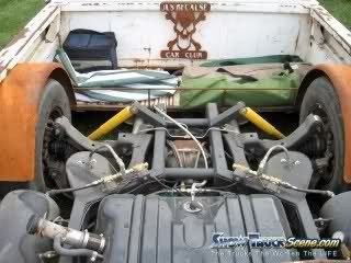

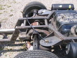

i would go with the thunderbird style. i have it under my truck and i just modified the stock subframe it came with to bolt to my custom frame. i am sure it would have to narrowed for a ranger. i redrilled my own hubs and it was not that difficult,and i have about 150.00 in the whole setup.

Just run an rx7, Theres like 3 or 4 of them here in az on craigs list for like 150 bux complete.

ive actually been thinkin about runnin a tbird irs but i found a few jags at the local junk yard that i was gonna rip it out of then my buddy went and bought em all!!! shitty so im thinkin bout the t bird again

i bought a irs out of a s13 240sx for $50. its 4 lug but i found a set of hubs and disc's off a 90 300zx (same as ranger pattern) that will bolt directly to this irs for $50 each side so ill wind up having $150 in the whole setup. oh yeah and its the same width as the ranger axle so no shortening shafts.

heres mine i just got it all. i still have to get the subframe unbolted from the car but this is basically the heart of it all. 1993 240sx rear and axles with 1990 non turbo 300zx 5 lug hubs, discs, and calipers. $50 for the rear end, $150 for the 5 lug conversion. its 61.5 inches wide hub to hub.
