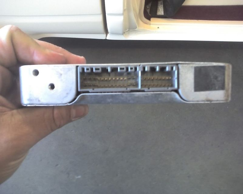

WAYNE, DOES IT LOOK LIKE THIS?
LEMME KNOW, I MAY TAKE U UP ON THAT...

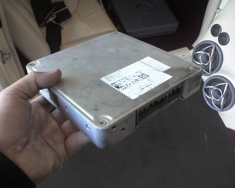

josh, there are a couple differnt computers. your white sticker there that is destroyed has the answer to your question. there are numbers and letters on there. if my memory serves me correctly the first 5 are what you need from there. i am sure a dealership could give you the info you need from your VIN. the reason yours is running bad is because you got the wrong computer.

the first 5 digits on yota ecu's are always 89661,if you get me your vin# i can tell you the last 5 digits of the ecu you need,and what years it fits.
