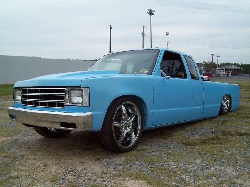

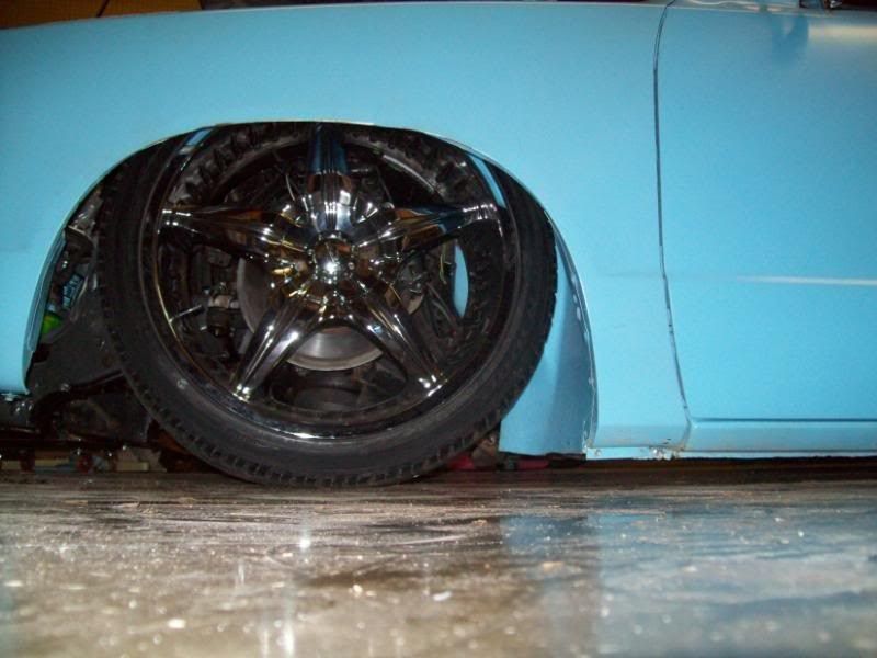

Sorry that it took so long but here is a pic of the truck with the lift in the front. In the pic it show that he gets enough clearance but once he sits in it it goes a little bit lower to where he doesn't get enough lift.

not trying to be rude, or cocky, but, what more lift do you need? my truck doesnt even clear the tire when locked up....ive never understood the need or want for that much lift.
bagged4doorcivic's avatar
bagged4doorcivic
not trying to get much more lift. He can't turn without hitting the fender so I was just trying to get at least one more inch or so, but I have yet to put on the stock spindles to see if that would help it.

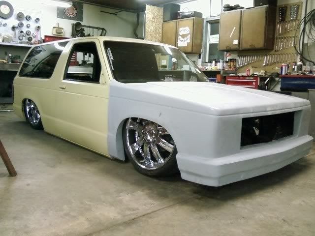

mreed
I have the same front set up on my Blazer. Tube arms, drop spindles, 2500# bags but I have 22's and 3" upper cups. If you change to 3" cups he should have even more clearance than I do since he has 20's.
...and I think he has the same wheels as I have on my "pick up parts" truck!
