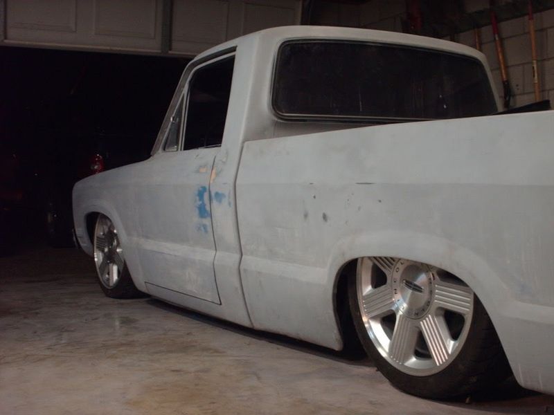

Slammed83Mazda's avatar
Slammed83Mazda

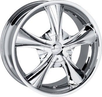

What im currently running.
What I want to run
jdm customs's avatar
jdm customs
If you can get those wheels in a 41mm+ offset they will work. that is if you have 3mm extra room in there, which it looks like you should. I checked those wheels by the link and all i saw was 6x139.7 with a 31mm offset. for those you wounld need to be able to atleast slide your finger inbetween the navigators and the fender since you will be losing 13mm which is a hair over 1/2 inch.
