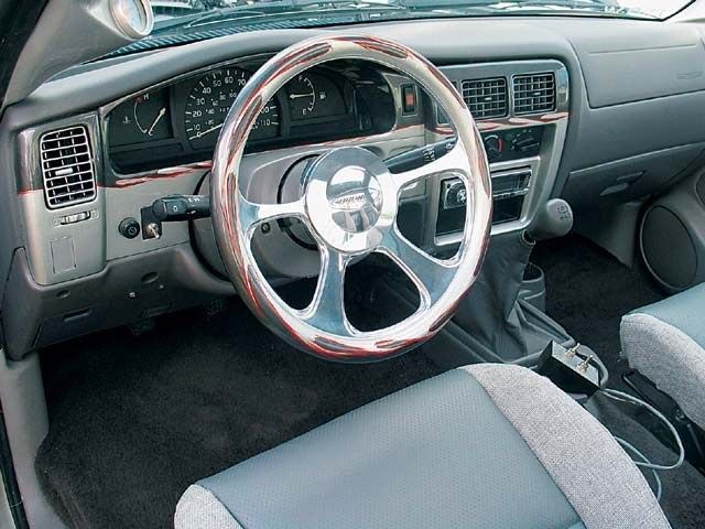

Ive read that the splines on my taco are the same as the older pretaco trucks, so i'm pretty sure i can get a grant adapter, but i think the grant wheels are all 6 bolt holes, and the wheel i want is a ten bolt. Does ayone have info on different adapters that will work on tacomas? Any help would be great ASAP

i put a colorado custom wheel on my tacoma using a 89-95 lecarra adapter...

Yes you can buy an adapter. Use Lecarra @ www.Lecarra.com and get the 89 to 95 toyota tacoma import hub. It is a nine bolt. then you will have to find a nine bolt wheel and sometimes the bolt holes on the wheel are smaller than the hub so you may have to hollow them out a little with a drill. i bought a klassix wheel.

u also used the lecarra pre taco hub....its for the 9 bolt wheels....Budnik, Colorado Custom, BAD, Billet Specialties, Intro all use the 9 bolt hub....grant and apc and possibly aim use the 6 bolt
