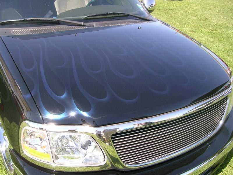

almost any color pearl will be good over black, but when spraying remember that less is more! you likely won't be able to see the effect of one or two coats of pearl until it's in the sun, so DONT keep coating till you see it inside or you'll likely be unhappy with the result...
here's my blue pearl over black flames... and this was just one coat around the outline and an extra coat on certain parts for accent with an airbrush if i remember right... doesn't take much to have an effect.

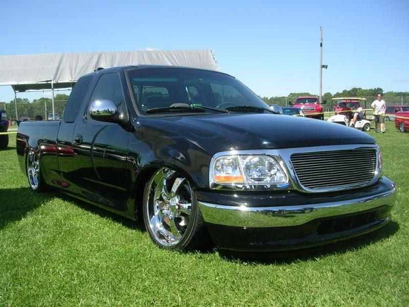

HERES MY YOTA FROM 97 its black with a ton af blue pearl and in the sun it was blue but in the shade or at night it was jet black
