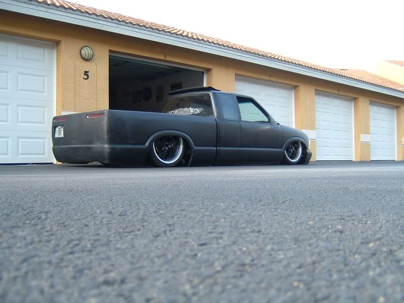

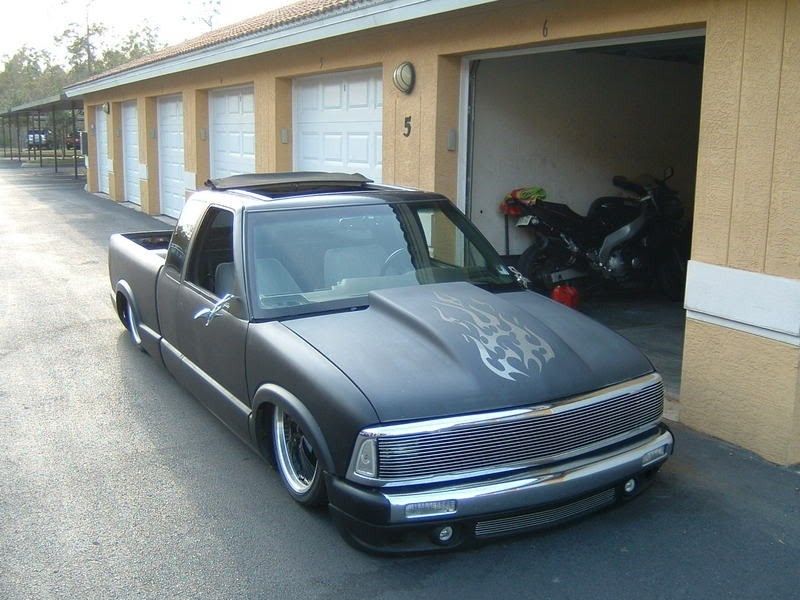

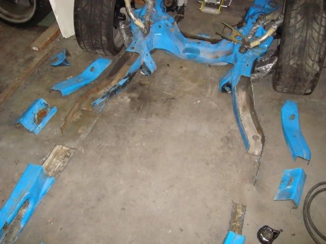

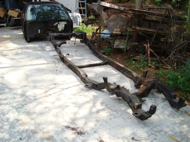

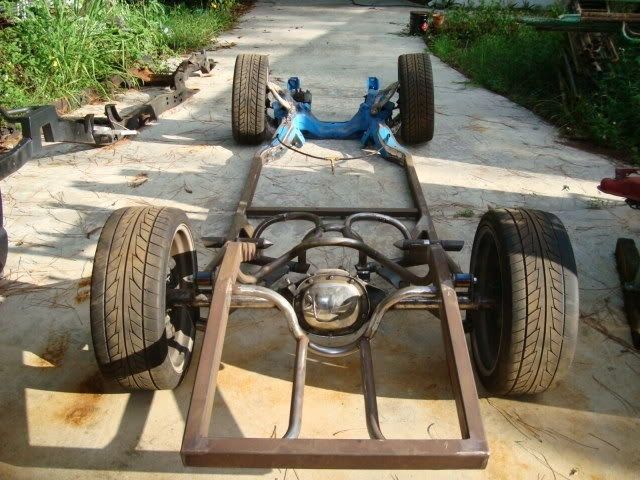

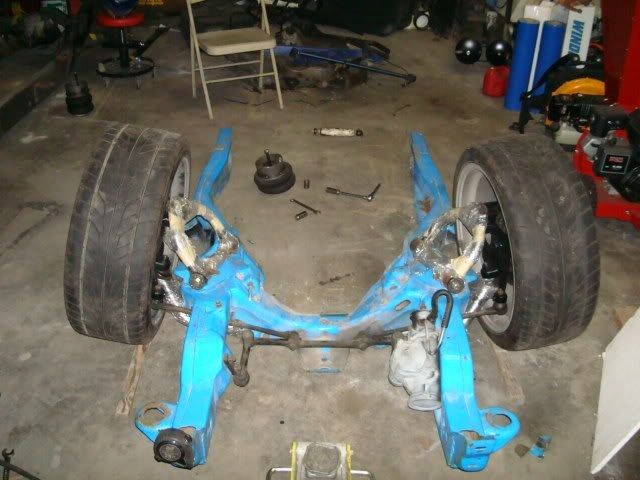

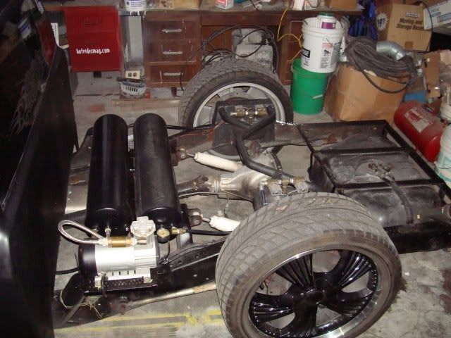

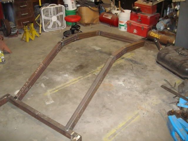

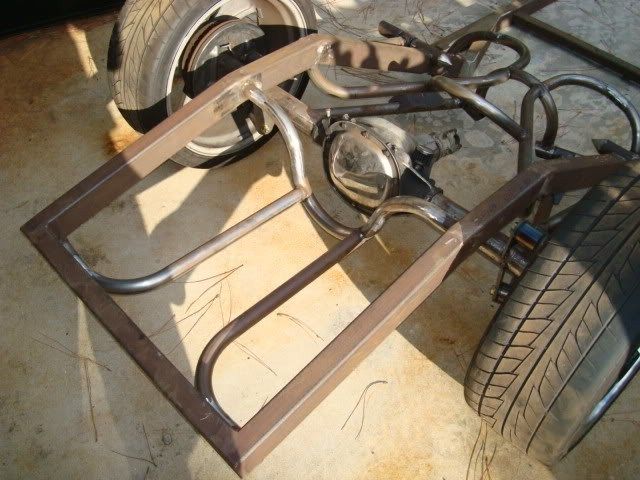

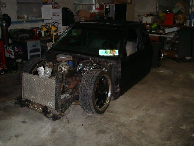

Edited: 8/10/2008 10:27:02 PM by BdydrptS10on20sWasup I've decided its time i do one of these u/c threads, so here is my 94 s-10 will be a "not so stock floor" stock floor body drop. Also will have a 350 SBC and Many interior and body mods. It has 20's on it for the build but everything is being set for the 22's i just havent made my decision yet on which ones. I'll start with some past photos of it so you know what im workin with. This is my first attempt at a frame build, only done a few bag jobs in the past so with that in mind enjoy, and advise or critisism is welcome but please no bashing... Later

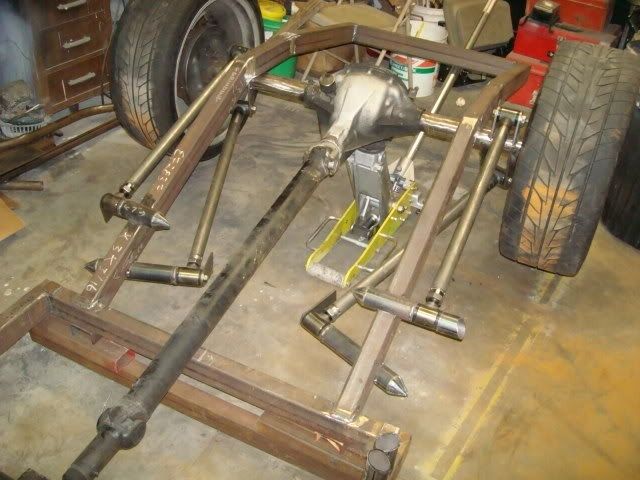

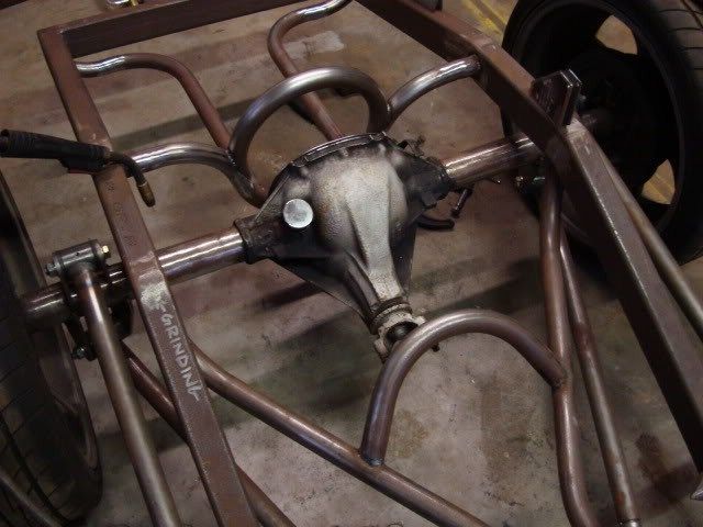

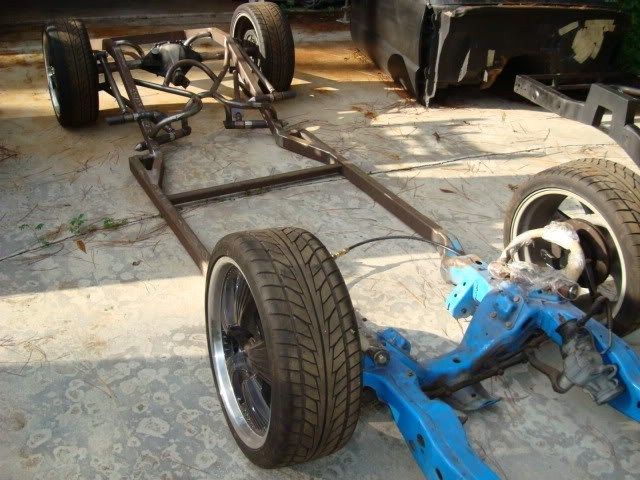

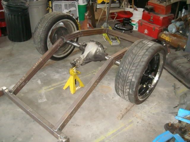

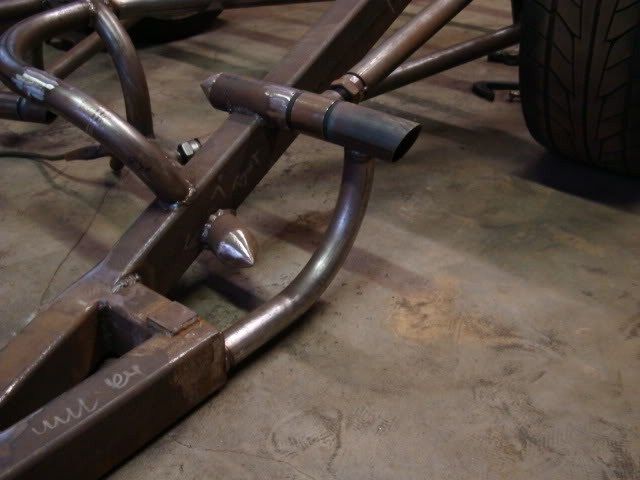

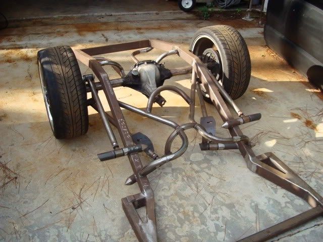

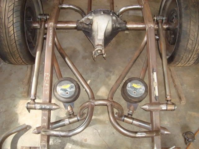

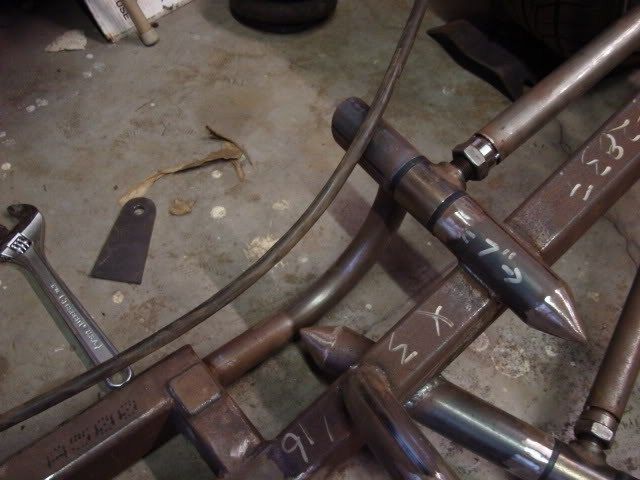

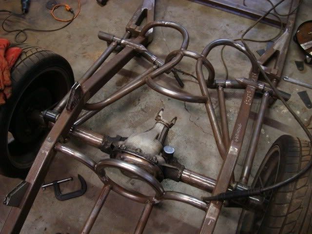

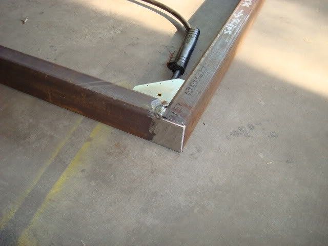

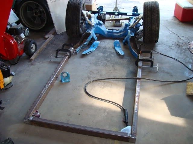

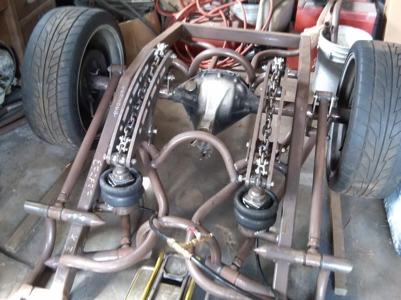

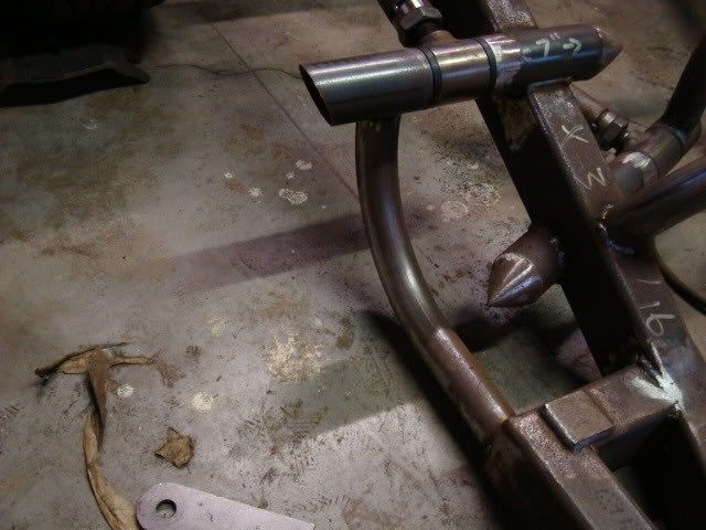

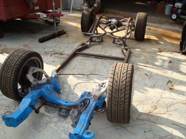

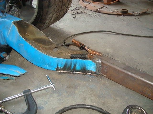

Frame is built from 2x3 3/16 wall and the tubing is 1 1/2 1/8 wall suicide doors arms and bag brackets not done with the tubing yet i still need to run bars to the upper outboard link locators and finish the fuel cell brackets for the rear but she's comin along
