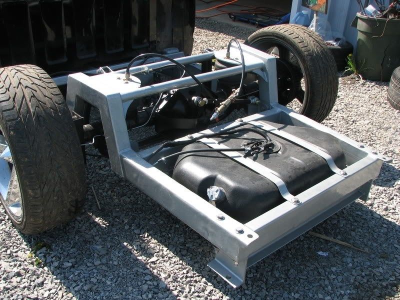

If you use our (fbi's) crossmember, you'll end up with an approx. 4x6 hole in the bed where the sending unit comes through. We include a filler panel that you can weld in to cover that up, but that's the only way you're getting enough clearance to keep the stock tank from dragging. Once everything is welded up and painted, you hardly notice the filler panel- just a flat spot on the bed floor...

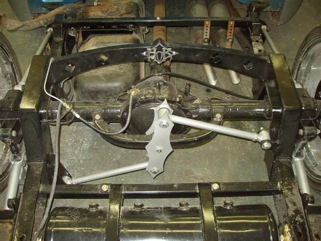

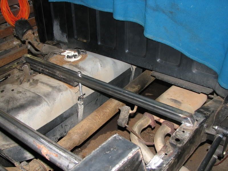

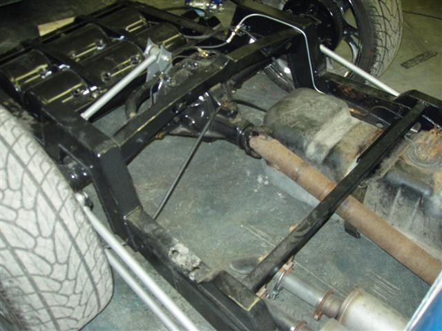

The one I built for a customer doesn't drag tank and nothing comes through the floor...
