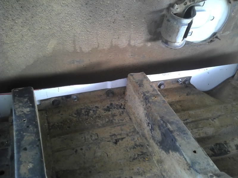

Ah yes the bed, if u wanna lay frame or close to it and not have something sticking outta ur bed, u will have to lift the bed up, ive seen some of the regular cabs do it and s10s. IMO it looks ouuta place with the rest of the truck. Last months edition of Truckin' had a single cab chevy, sq body with the lifted floor bed. Just not for me. Good luck!

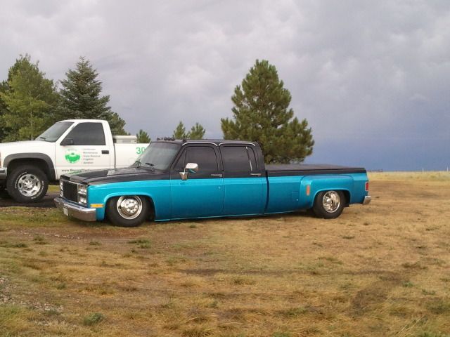

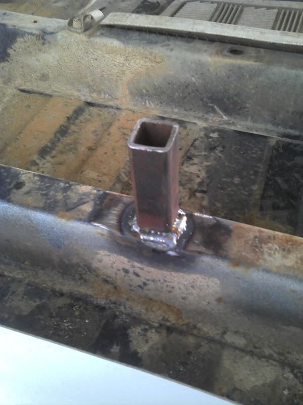

Mine has bolt in upper mounts on front.....lowers are just circle plate welded to arm....its alittle over an inch from layin....rear lays...i have a 2 link and my notches are kinda tall because i mounted my bags between notch and rear end....you can get away with a smaller notch if you cantilever it.....also the bed floors on squares unbolt...all you gotta do is unbolt them drill new holes X amount higher and bolt them back in then build some simple spacers to space it above your notch....i raised my bedfloor in about 4 hours...heres mine
