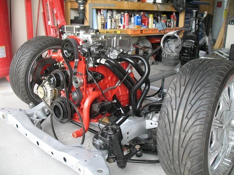

how to drop the frame horns on a b2000?

sorry I don't have any of the notching for the radiator because I'm running a shorter one and didn't need to also I didn't need to drop the body mounts because I made a new core support but you get the idea.. just don't cut the whole crossmember

i did mine like that also...just cut around the bumper and rad support mount. drop it and weld it up. make some triangle gussets for the buttom. and pipe notch the crossmember for the lower rad hose. doin it this way is easier because u can leave the strut rod.
