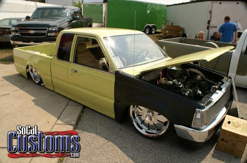

This truck is running a set of my arms with 20x8.5" wheels with 5.750" of backspacing. Its bagged and bd'ed with 2" drop spindles and 4x4 fenders.

do 4x4 front fenders look bad if the bed does not have 4x4 fenders? when i air up with 17's my front tires scrape but very little. iv got 2wd fenders on the front right now, if you have pics post'em

$550 + shipping. They are jig built so they are the same everytime I make a set.

hey chris how much is this truck BD'ed?also is it runnin 6 lug or 5 lug?and do you have any other pix of the truck?

Thanks Nick! I'm not sure exactly how much the truck is BD'ed but I can find out, i'm thingking maybe 2.75" though. His name is Josh Ankrom and he's running redrilled 5 lug hubs in the front and a different beefier axle in the rear, thats shortened, to handle the power of the Mopar 360 under the hood.

damn everyone is runnin a 5 lug swap. its damn near inpossable to find a 6lug with the correct back space that will tuck. cuz ive been told i need around a +50ish to run 20's and thats without being body dropped. and im runnin a 2.75 bd
