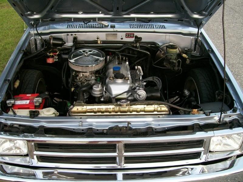

granth
I need pics if possible of a weber installed with all the crap removed that you don't need. Seth said he just kept the EGR but I have seen people say something about the vaccuum advance and shit. What all is NEEDED to run the truck daily, and can someone please post a pic or point it out to me somehow.

I can take a picture of mine. I am getting ready to pull the EGR off. I called Weber Carbs Direct, and they said it may be causing issues during hot weather, which I am experiencing. My kit didn't come with the blockoff plate, so they said they would send one. My kit actually didn't come with A LOT of things.
But all you need to run the Weber is the vacuum advance. Thats all I will have once I remove the EGR. That thing is ugly anyways.

Oh yeah, the vacuum advance comes off of the carb, and goes to the dizzy. You can plug all the other holes. Standard pipe thread. 1/8" NPT where the V/A was originally hooked up, 3/8" NPT on top of the manifold by the EGR plate, and 1/2" NPT on the side below the carburetor.

check my profile, i have a picture of it like that on a 78 20r. but its a 32/36 and i removed all the fenderwell emissions stuff. tossed it. i put a pipe plug in some weird thing in the radiator, one in the lower manifold and one up high on the manifold. i kept the egr valves and tube but removed and plugged all the vaccum stuff for it. i want it gone, but the kit didnt have a block off plate for the back of the head, just the part on the intake. also, for the valve cover, there are two holes. one went to the air cleaner and one went to the pcv line. im not sure what to do about those, so if i can get an answer that would be cool.
but yeah, hook up the vaccum advance line, i left that little valve thing in line. do i need it? i also gave the truck a slight bit more timing. runs like a champ even with stock exhaust. i got a header to go on soon.
oh, one more thing. if you have the smog pump, you can remove that and the lines to and from it. i didnt, i just pulled all the stuff from it and removed the belt to it. i want to keep the a/c usable for when i recharge it and put an idler in the smog pump spot. it makes a shitload of noise if you let it spin with unhooked lines.
