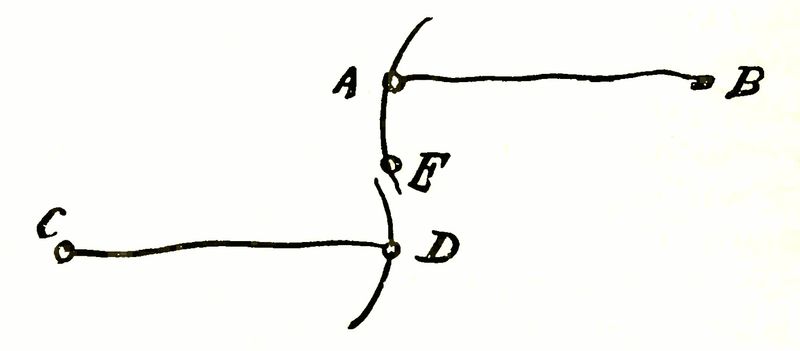

Might want to consider a watts link, in my opinion it is the best route and not much more work.

on my first dually i had a panhard bar, and i hated it it pulled the rear end way to much thru the travel of the suspension. on this one i have the end of the 2 link bars connected with a 2x2 piece of square tube .25 wall. and also have my shocks mounted on that also. but im planning to redo it and going with a watts link, way more efficient than a panhard and not as agravating getting the rear end true center when layed out and you dont look like your dog legging going down the road..
