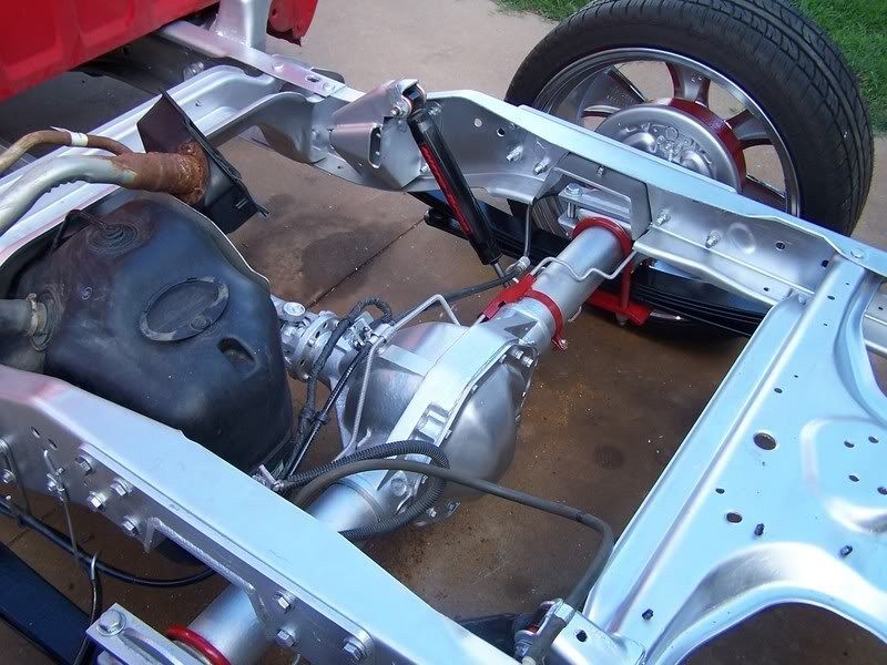

I painted my whole frame with it. Its amazing. I sanded the frame all down to bare metal and then marine cleaned it rinsed, metal readyed it..let it sit for 45 min then rinsed again then blew it off and painted. you can paint or prime right over it and bondo or fiberglass also. I dont plan on topcoating my frame cuz its under the truck and wont get much UV rays....oh and dont get the shit on you, it will be there for bout a week!! good luck

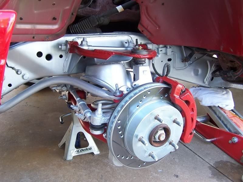

ha ha. me too. i was just gonna say that. yeah i built my stock floor frame like 3 years ago on the f150. dont think i did anything to prep it really. i just brushed it on. it is still holding up great!

I used the Sterling Silver topcoat on my frame. My frame was really clean and rust free so I just clean it up and brushed it all on. It took a long time to do but I'm happy with the end result. It's not suppose to scratch but it does. Not bad for a daily driver.
