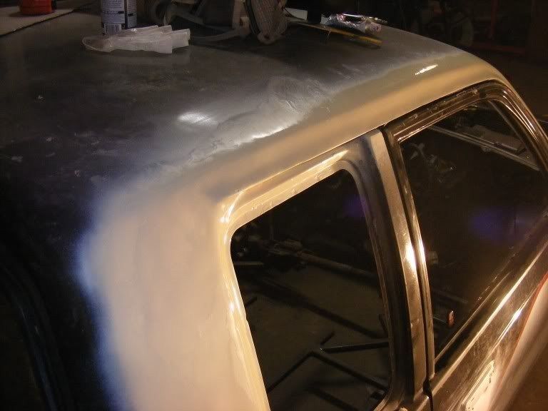

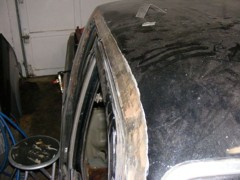

scotto79
I welded a piece of rod inside and hammered the edge over and welded the top lip as well. Then its just a matter of a little filler and sanding.
scotto79
another pic before filler and primer
