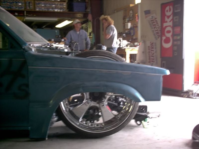

this is mine if i bd'd it to the rocker and its on 255/30/24's. witch they are stretched over a 10 inch wheel, (275/25.24's were out of stock) so with them stretched like they are mine are 29 7/8ths inchs tall. id have to raise my hood and fenders 2 3/4inchs to get the tire back under there and there already above the bed in the back just laying frame.
but to answere his question. i just mod'd the lowers, triangulated them pie cut the upper and put in new moog ball joints. i also z'd the front 2 inchs. its on stock spindles also.

sorry heres the pic.
