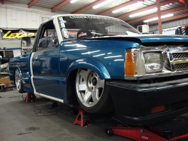

hey tha truck looks good,im glad that i had you as professionals do it.

I was there today and saw this truck in person. The work looks good. Im sure the guy will be happy with it. Jay has stepped up and is turning out some nice rides at the shack.

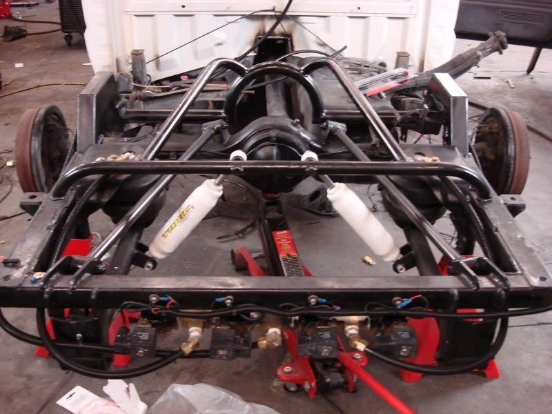

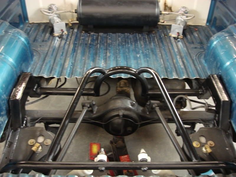

The same setup just got cut off my mazda a couple weeks ago in favor of a forward facing 3 link setup with cantilever bars in the rear for the lift. That full reverse 4 link sucked so much ass and loved to shred carrier bearings.
Props on the work, it looks good just not a fan of the reverse crap.

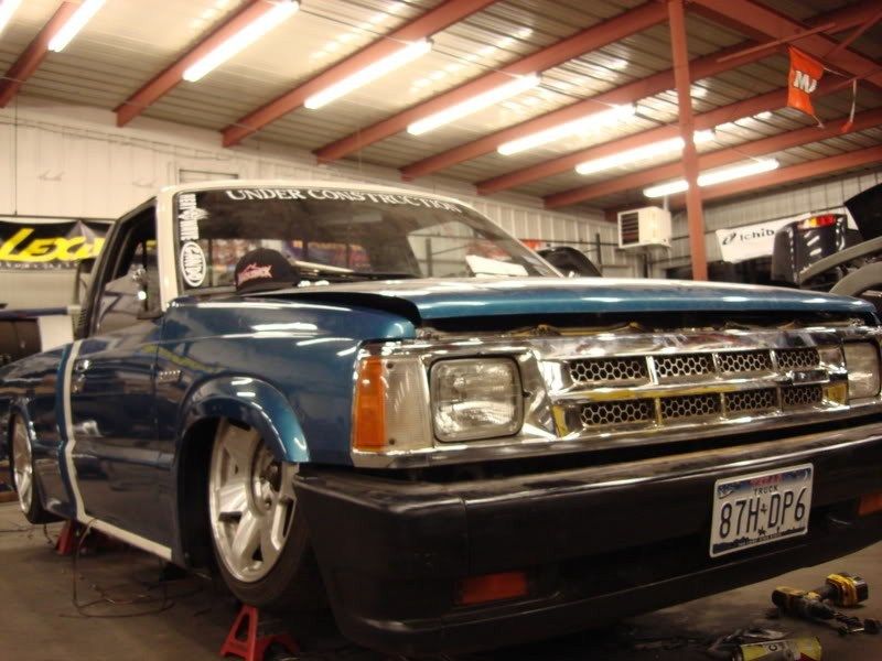

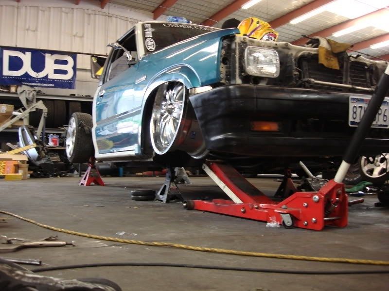

hey everything looks good bro.
mazda2
sorry joey,but the top has to stay,id like to cut the to off, but im on a budget rite now.
