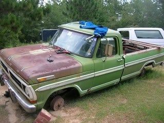

This is my truck so far. She dont look like much,but as you can see I found her kinda rough. not to bad for a $250 truck. even got a 351 windsor.
