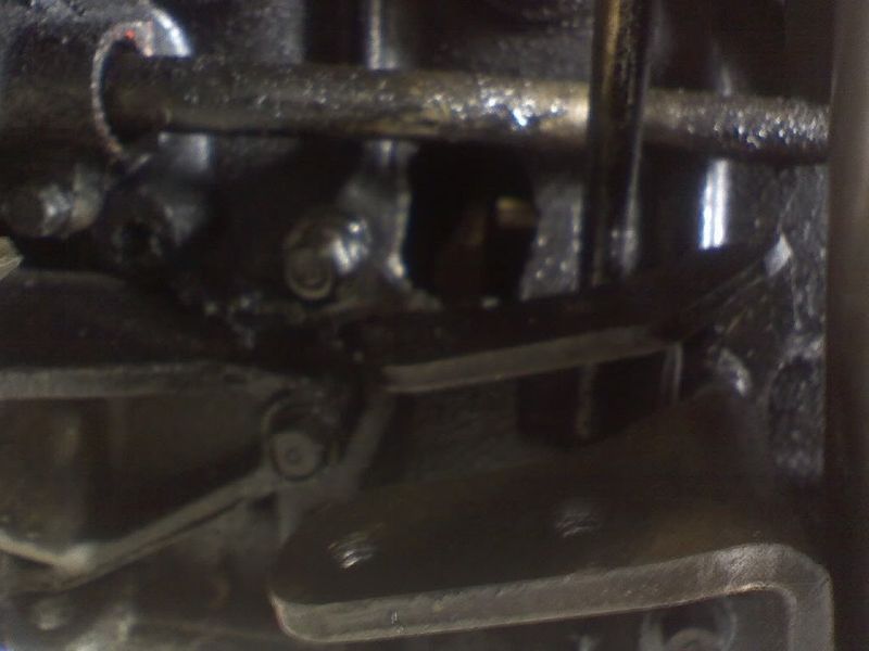

anybody tell me whats wrong with my motor? :LOL:
Lucky's avatar
Lucky
Um....it has a whole in the side of it ...?
mazdarado's avatar
mazdarado
Looks like someone overported your block.
