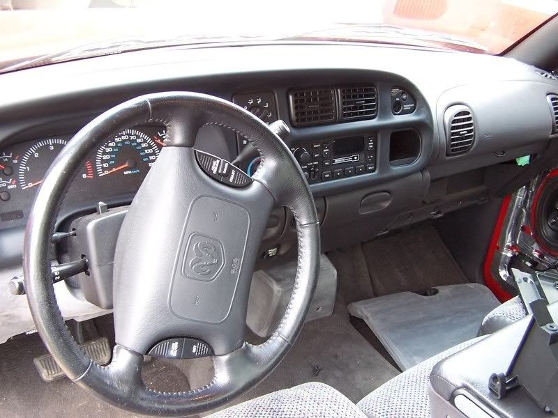

I've done it with different grits. If you use 80 you might warm up the plastic and make it stick to the texture then you have a lot more work to do to get everything smooth again. Did that make sence? I just sanded down my air intake and I used 220 grit and it seem to work a lot better.
I worked my dash over until it was completely smooth! I wouldn't go with ruffing it up and then primering over what's left of the texture, I would try to get the best of it out.
2000 Dodge Ram. I shaved and relocated a few things too.

^^---thats really cool how you moved the center vents down in line with the outer vents.
nice dash!
