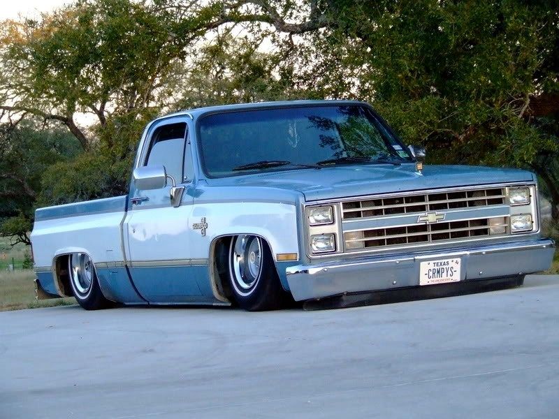

My truck has a 1.75 inch Z and lays out on a 235/75/15 (same as a 265/35/22) with stock steering and ALL stock floor.
