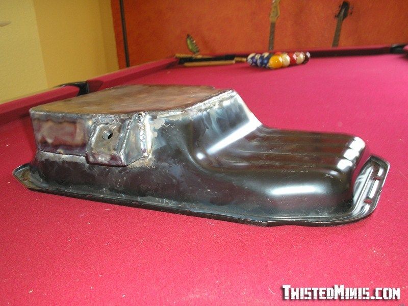

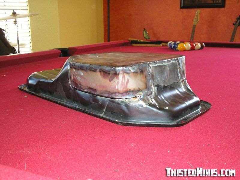

On the oil pan you should only need to remove the third sump. And there are a couple of ways you could do that. I did this one for a guy that wanted to retain stock oil capacity.

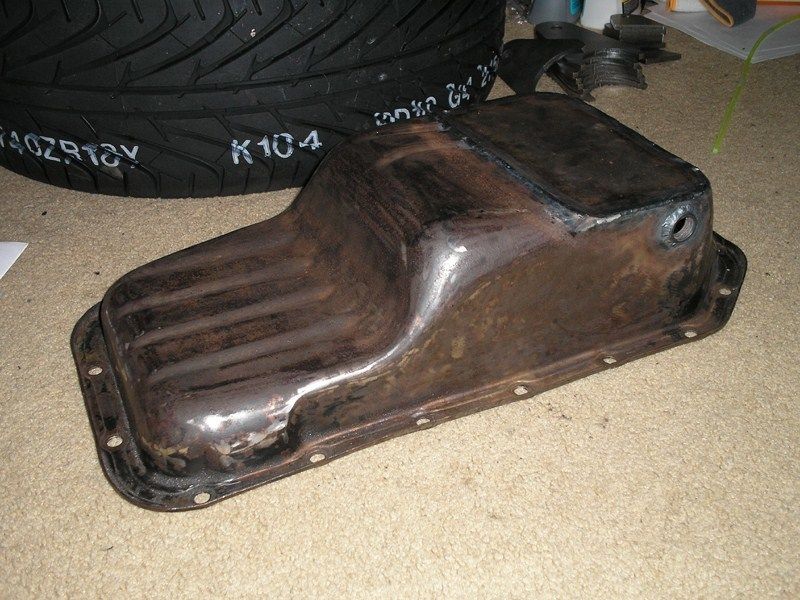

Basically a sump pan. Or you can just literally cut off the third sump and plate it. This was the first pan I did for my truck.
I lost about .3 quart capacity. You could easily gain that back with a remote oil filter.
