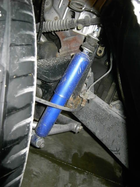

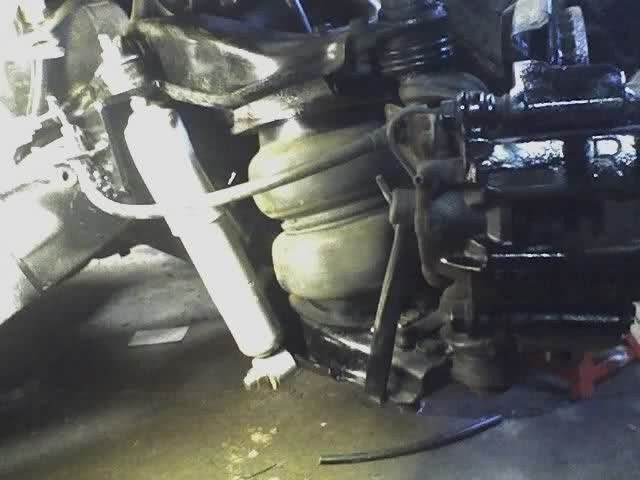

i need to see some pics of 89-94 toy front shock relocations.i have the suicidedoors brackets(the upper bracket is for a stem style shock).i know the shocks will go on the back of the lower control arm.it seems that i need to weld the upper bracket just below the upper arm. please give me a pic so i can get this over with.thanks.

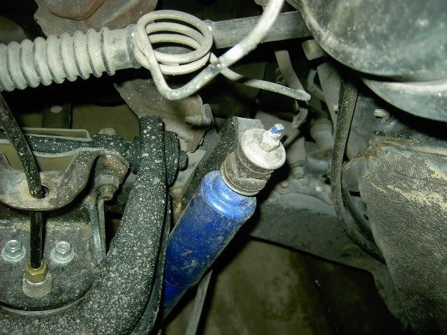

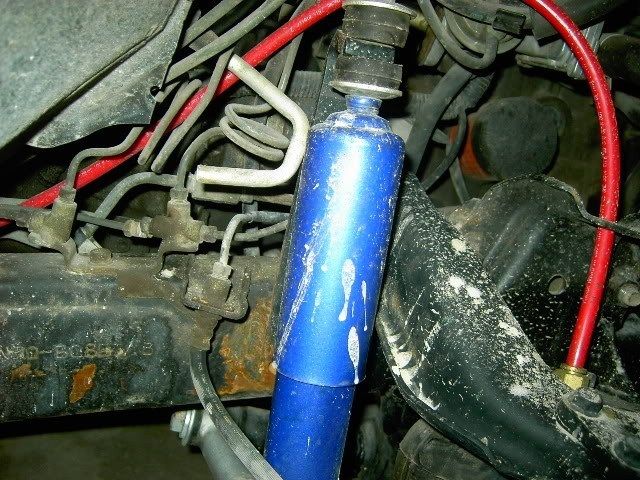

sweet!thanks for the pic. do your upper brackets flex since you don't have any gussets?

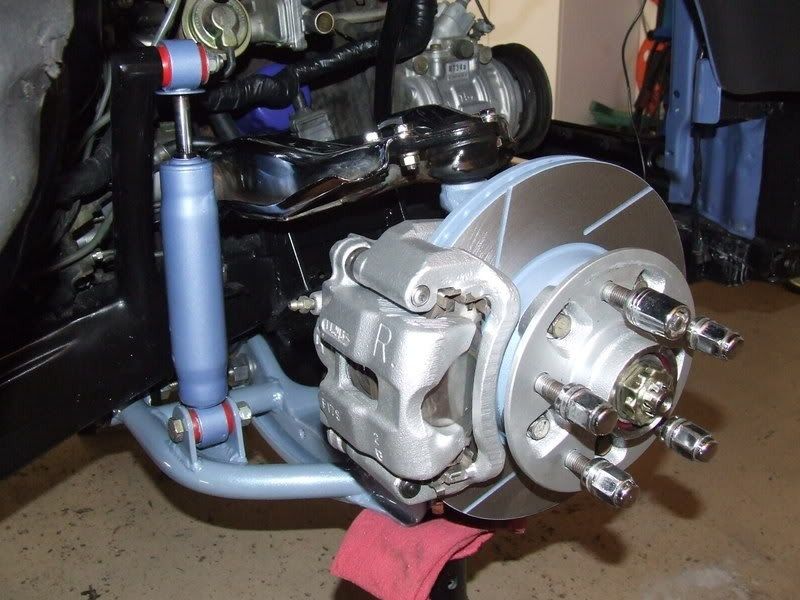

i found a monroe shock thats 8" collapsed.worked great and i have a load of room before my tire would hit.heres a crappy pic i took with my phone real quick...
