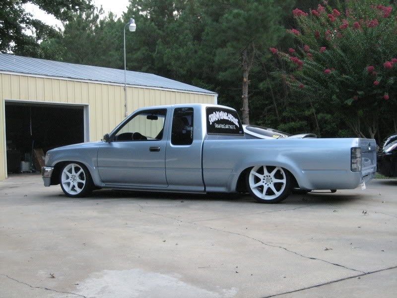

can i ride this low without a bodydrop?

yah, just raise the frame into the body, instead of the body over the frame.....wait......wait for it....
given that trucks body dropped......riding that "low" would call for a body drop. now your FRAME can be as low as his.....but to match it, you will need a body drop.

Actually yes you can ride that low.
The way toyota frames are, you could roll the way he is.
But you would literally be cunt hairs off the ground in the back and, obvioulsy, a little higher up front
The way he's sitting is about how non bodydropped toyotas sit layed out(with stock front crossmember and not z'd)

if you build the frame to lay flat then you could get it about 1-2" from that stance w/ out "raising the frame into the body or w/out dropping the body over the frame" but you will definately need to Z the front clip and build a new tranny xmember to get a toyota to lay-out front to rear. it wont be to the doors or rocker but itll be close...

that pic looks like its definately b-d but its aired in the front to drive

i agree with tyler. it looks like the frame could be a 1/4" off the ground in the back, if it weren't body dropped. toyotas sit pretty low laying frame. so yes you could drive that low, just on a very flat and smooth road, and until you ran over a reflector or something.

You can definetly ride that low without a b/d.....This was my ride hight in my yota and if i let the front down enough i could drive just as low as that pic

This is how I ride around most of the time.Its not as low as it can go in the front, but I do have a c-notch in the rear to help out some!
