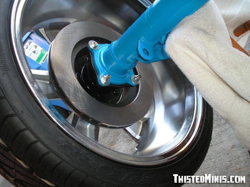

86 Mustang SVO rear rotors, GM Metric front calipers.
BAGGEDTACO45
lol im an ass i just found it in ur profile sorry ,,umm but what size steel u use for the bracket and how you figure it out or is it just self explanitory
TwistedMinis's avatar
TwistedMinis
I made a paper template and cut it out of 1/4". If I did it again I would probably make a trial piece out of sheetmetal and get it perfect, then have it laser cut out of 3/8" plate and try to use 3 holes instead of 2.
