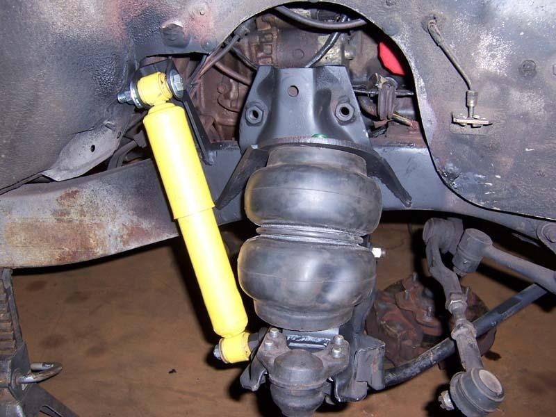

on the pic of that front set up why are the ball joints upside down
societyoutkast
so i have seen a few diff designs on brackets aim has some that are bolt i mean whats good to use i know there is not alot of room
get twisted
do not use AIMS the reason the lower balljoint is flipped is for a little more drop and a little less binding on them
societyoutkast
ahhh i see well i have 2 1/2 drop spindles on it right now so what should i do bracket wise and is there some more pics of front ends
gslow2600i
Check candospecialties.com under faq's they have pics from a toyota which is nearly the same front set up.
mindlissmetalfab
I've got an extra set of torsion bar bag brackets that I will sell for $50 shipped.
societyoutkast
alright i think thats all i would need is just brakets for the front right nothing else special
fatboysS1O
yeah dont buy from aim, total crap through and through, even if u dont buy from me dont buy from aim!
ShavedMazda
Here are some pics of my front setup but they are not that great but should give you the idea of what you got to do.
