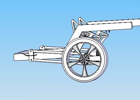

just be aware that in solidworks assembly mode, there are no real forces applied. Therefor, a parallel 4link without a locating device makes perfect sense on screen. Not so much in real life. Solidworks' interface may be nice, but 2D in SW is slooooooooooooooowwwwwwwwwwwwwwwwwww.
