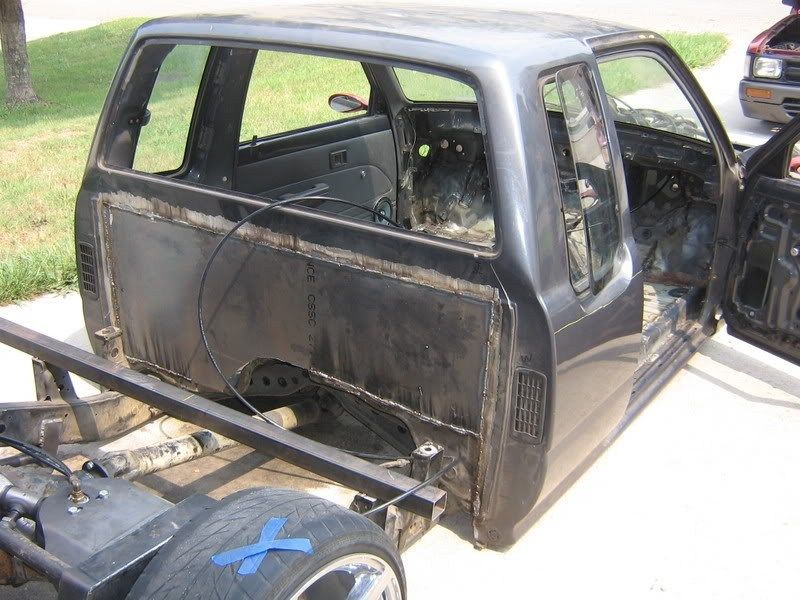

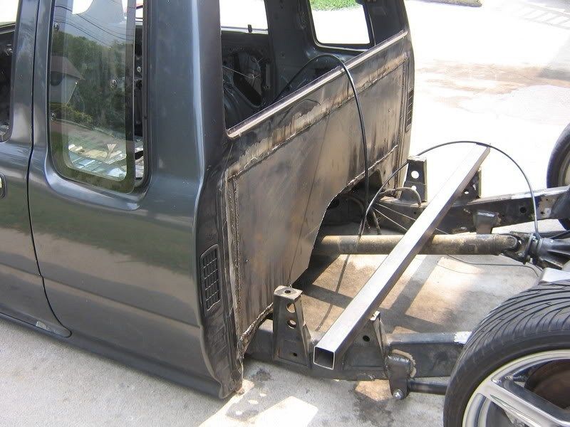

cnudrln
mines not a standard but might help

tim what gauge was that sheet that u used to shave your back wall?
cnudrln
that sheet was 16 gauge.

What are you guys using to streghten the back wall after you cut out all of the shape? Are you framing it with tubing? That stamped in shape provides additional strenght to the cab.
