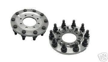

Only problem with that is that you cannot put lug covers on the studs.
We build a multi piece adapter that allows you to mount the plate on the outside of the wheel and still have the lugnuts on the outside as well.

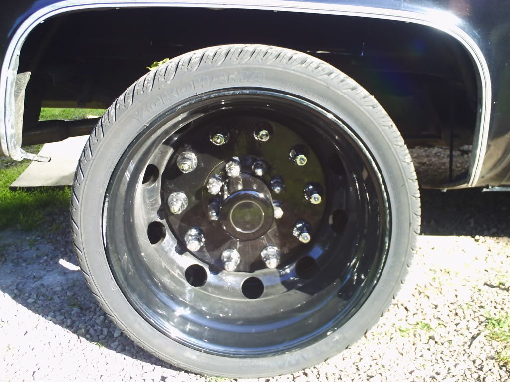

dually-79
I have done it with mine.

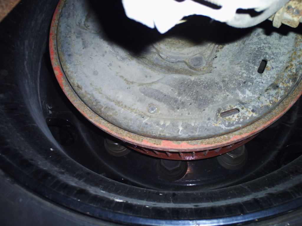

But i have a larger boltcircle , because i have european wheels.
I don't know if the bolts are gonna hit the brakedrum if you have a smaller boltcircle.
I save 6 cm
lockone's avatar
lockone
Our new adapters we have will not work with drum brakes due to clearance issues with the wheel and drum.

Mulit piece adapters. I'll try and get some pictures on them with installation. Right now they are just for newer Chevy and Fords with disk brakes.
