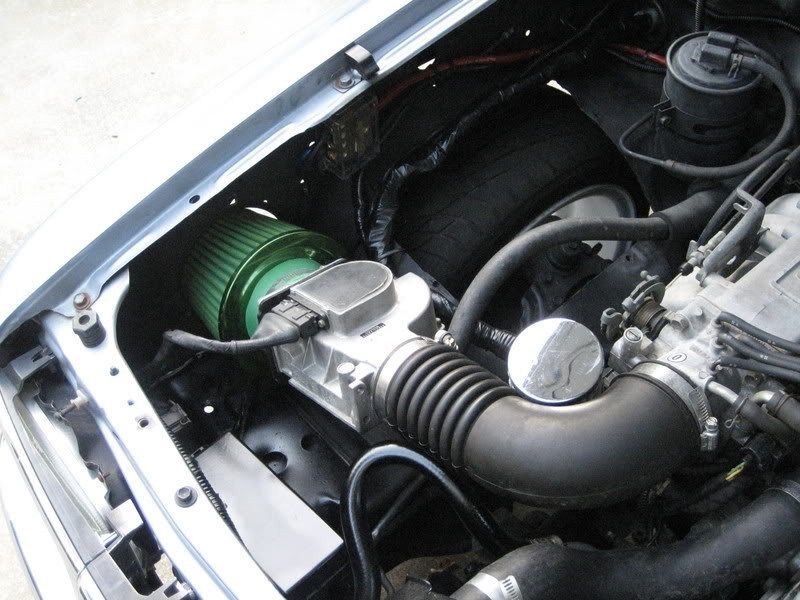

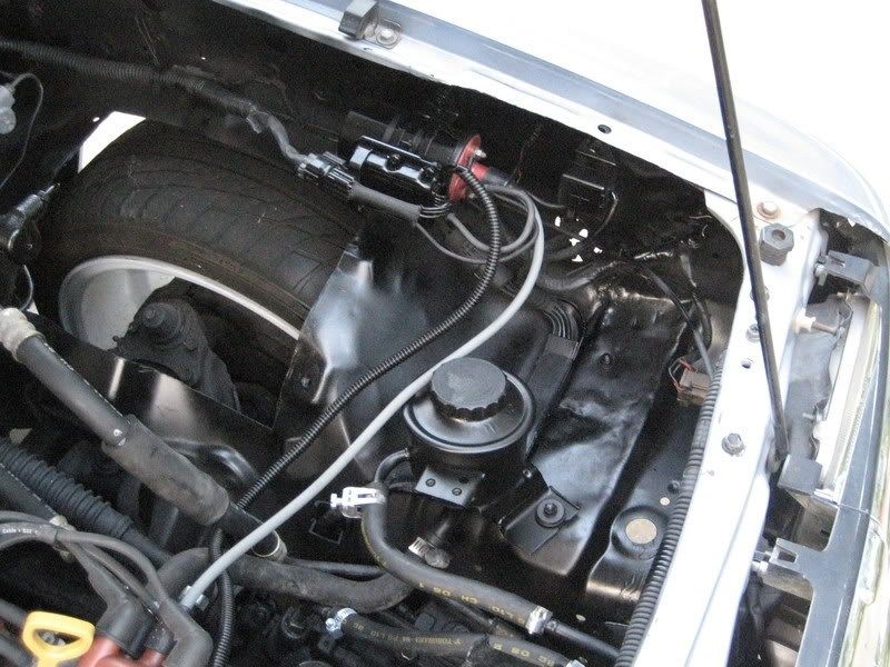

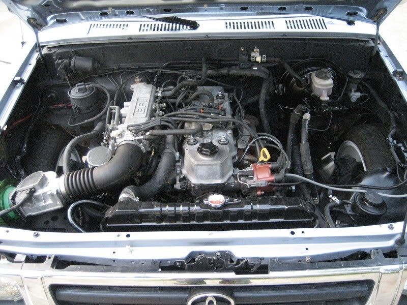

Im baggin my truck soon & while I was having my motor installed I relocated my battery to the bed, shorten/moved my intake, moved the power steering pump, ignition coil & also moved the fuse box close to the headlight. Ill post some pics to give you some ideas...
