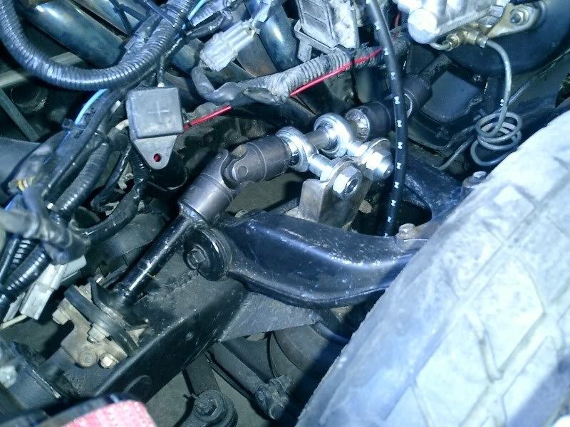

3.5"bd, 1.25" z'd frame
heres mine.. havent had any problems. i had to add a second heim because it flopped around too much when i would turn the wheel

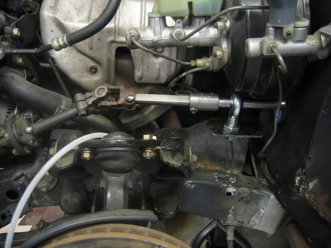

Go to the junk yard and look for some T-birds they have a "Standard DD U-Joint"
These U-Joints bolt on so it might make your install easier than those weld in types...
Although that installation above looks top notch with the weld in type.
