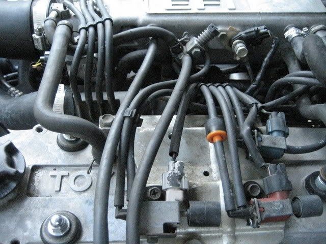

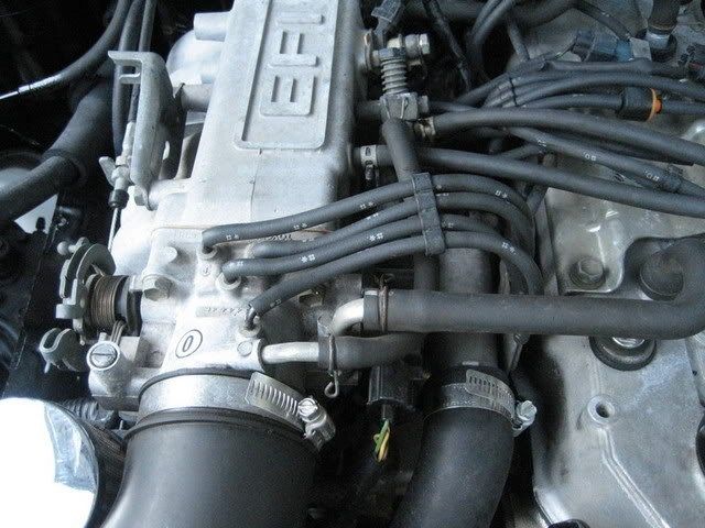

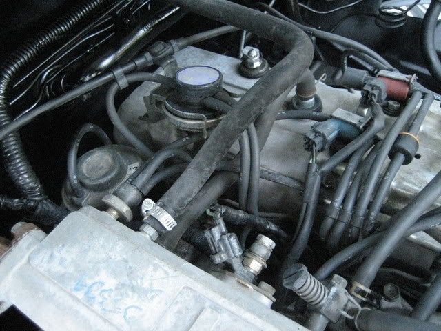

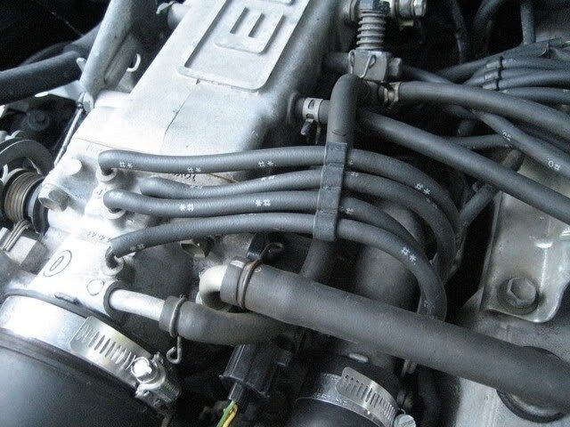

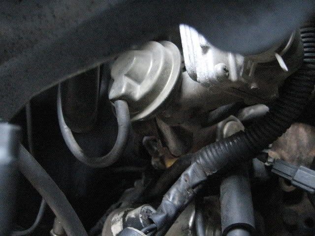

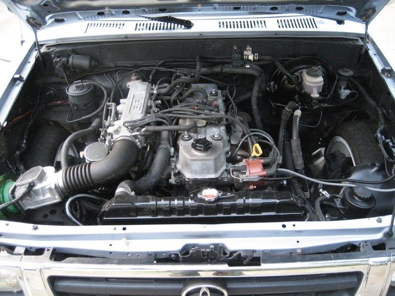

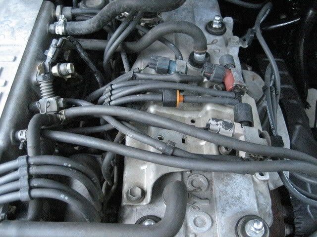

can anybody with a 89-94 toyota pickup (fuel injected) take some pics under thier hood of the vacuum lines hookups. I forgot to take pics of some @ scr8pfest this past weekend and I need to hook my lines back up... =\

See if these pics help...if you need pics of something else or closer thenv Ill get some better ones in the morning. Its going to be dark here soon & anything I take then wont turn out as good!!
groundedwatts
thank you sooo much bro! that should help out tremendously!!!

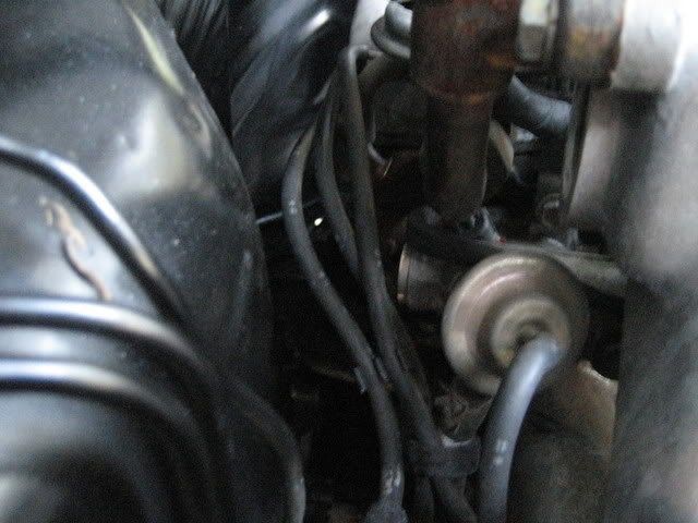

Ok...here are some more pics, hope they help!The 3 hoses that you need to connect go to the following parts on the motor...the top hose goes to this: its on the rear of the fuel railthe second hose goes to this...its located under the efi manifold towards the rearthe last hose comes to the top of the charcoal canister thats located on the firewall, but I didnt take a pic of that, but if you need it then Ill get it.
