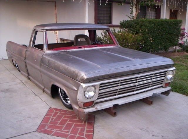

I used an 89 lincoln lsc mark 7 8.8 posi rear endsame boltpattern as the ranger and it comes with disc.
BAGGED 68 FORD's avatar
BAGGED 68 FORD
Oh! i'm also running a 89 302 efi out of a mustang with aod.
laidout83ranger
i am using a 8.8 out of a 92 lincoln mark 7. narrowed it 4 inches on both sides just to put on wider wheels and because it uses disk brakes
