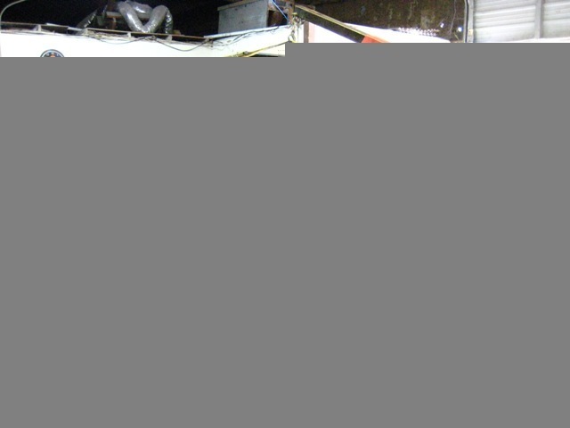

Or another method, but it's best to reserve it for beds that are already fubared like this gooseneck newbie victim:
I've lifted them off the frame straight up with ratchet straps hanging from garage rafters, on short beds I run a pair of straps in an X from the stake pockets and pick them straight up with an engine hoist from the rear, etc. (Long bed, most engine hoists don't have enough reach to make it to the center from the rear)

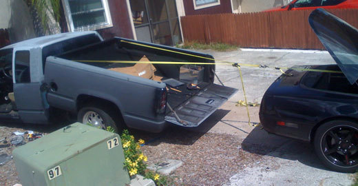

OH almost forgot about this one, I think I originally saw it on FSC and it cracked me the hell up,

hahaah thats awesome that you saved the pic! lol thanks for all the info. it will soon be time to tackle this project (ugh)
