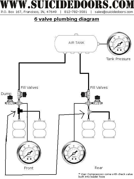

can i run 2 crosses and 2 tee's?? ( on sd.com ) for the 6 valve it shoes teh back fillin gup at the same time and dumping at the same time, to run a 4 valve thats all i woul dneed to fill and dump woul dbe 2 crosses and 2 tees correct ??

ok, if you're running outta a one port tank, here are the parts you need from SD doors. But I would just go to a home depot or M&D to get the fittings, its much cheaper, but make sure you get galvanized and not black. out of the tank, you have a nipple to a cross (4 way) on one side you have your pressure switch and the other your compressor. on the top another nipple going to a tee (3 way). a nipple on each side and both going to you're fill valves. after the fill valves, another nipple to another tee (3 way). on one end you have your dump valve being connected to the tee by a nipple and on the top you have a male PTC connector for the line to go to the bags which will eventually tee to each bag. that is all. That is all you need to get. write it down and go to home depot because they have all the fittings and its cheaper than SD doors. if that dont help, I don't know what will

ahhh.... welll...can you draw me out a diagram.. i understand what your saying but i cant picture it all in my head at one time...oh4sho said he was going to but he hasnt emailed me back any of this drawings... it would be much appriciated..

will this work ???

yes that will work. But I would put the fill valves coming right out of the tank, take out all that slack airline before the valve. and the extra ports on the tank could be for 2 compressors and 1 pressure switch.
