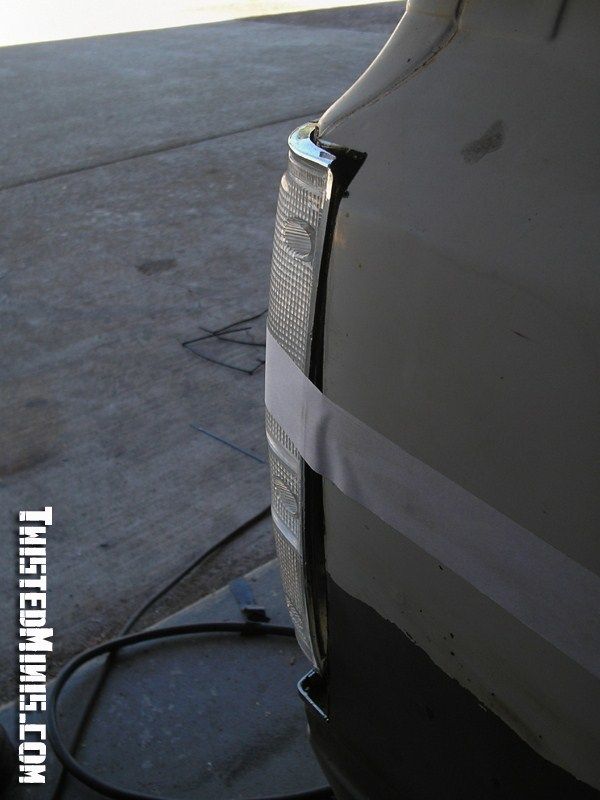

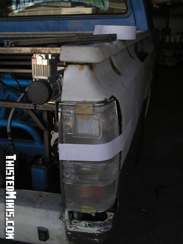

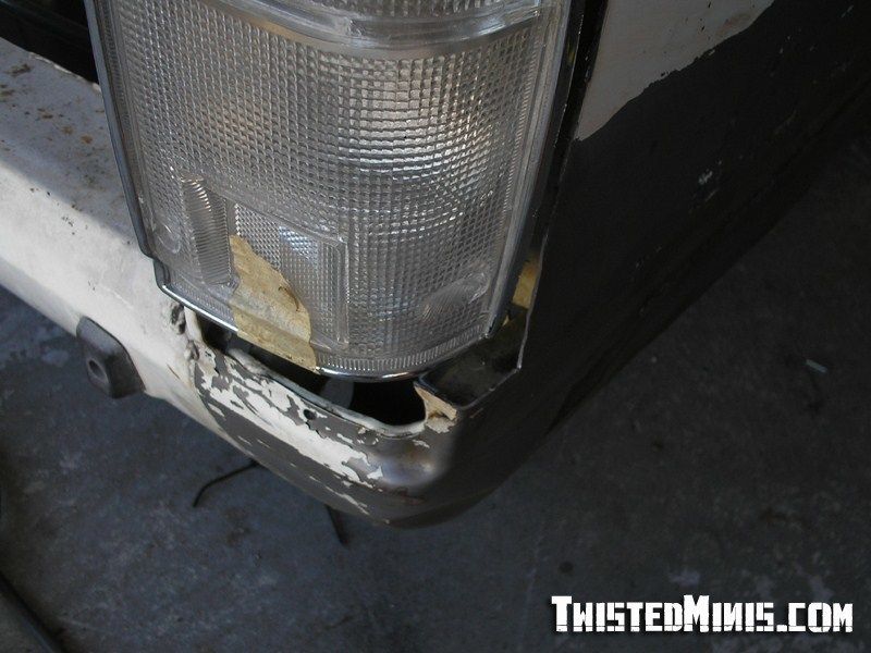

Okay here it is using the right tail light.
And with the left light upside down.

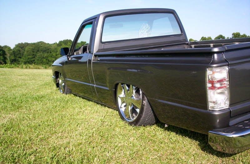

here is what they look like on my 88 with those same tail lights. it might help to see it on the truck they are designed for.

Yeah I actually have about 1/4 of each bedside.

Looks like it might help if u drop em down even with that top bodyline Seth or maybe just a lil below like they fit on original truck??
