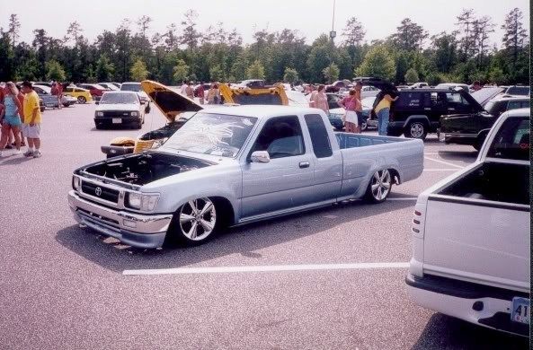

its a 94 dropped without bags

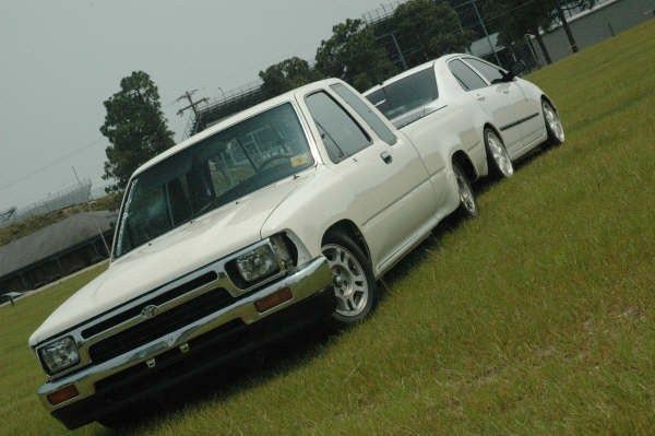

lowered my 92 3"ish all around and i barely tuck tire. they have room for alot more. im on 195/75/14s.
