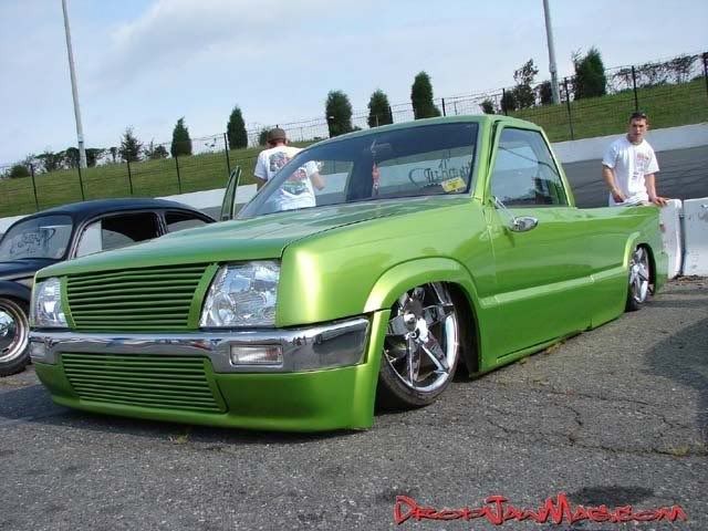

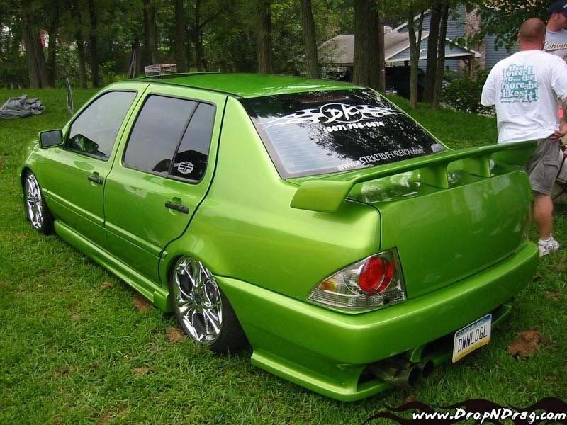

anyone know either of these colors?

looks like a dupont hot hues color.
SoLow03
Maybe Midori Sour from Dupont Hot Hues like James said. There are tons of green metallics out there, but that is one of them to start looking at.

Looks like Lime Time pearl from House of Kolor.

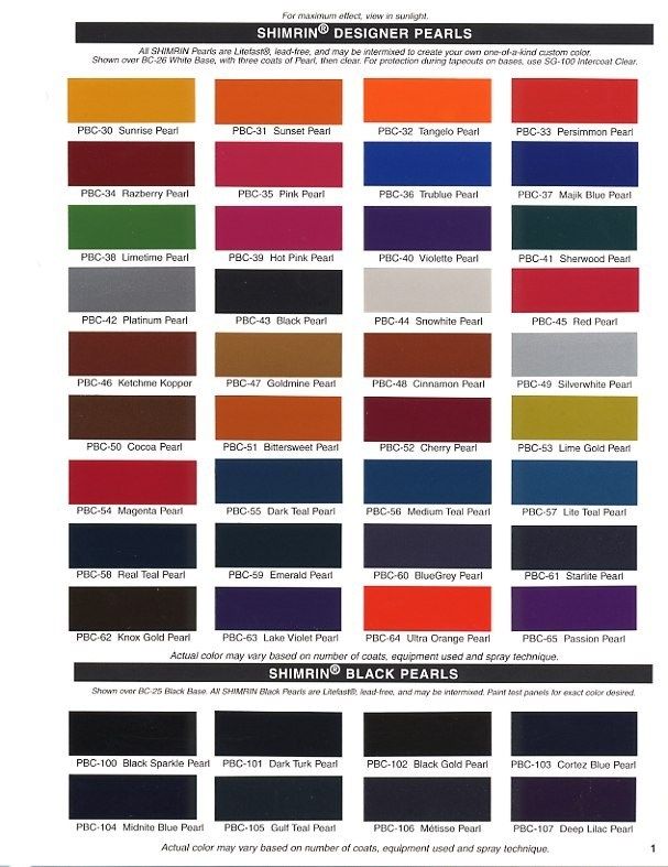

its limetime green im almost positive
looks duller on the color chart but thats it

i painted some motor parts limetime over white and it just dont seem to 'poop' anywhere near like those 2 do. its like good in person, but when a pic is taken it looks like a factory green.
i would really like to figure it out lol

try spraying it over silver

Why are you wanting it to "poop"? In that case you might look at the Goldmine Pearl on the color chart above.
