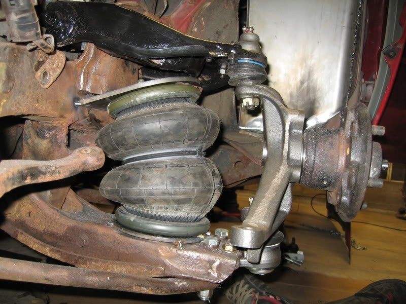

Has any one had to trim there upper control arms because of hitting the upper bag mount when the bag is fully inflated? IF you guys could post some pics or let me know if i should trim them and if so how should i reinforce them thanks alot

hey here is a pic of whats going down you tell me whats wrong

i did, mine hit the actual mount though not like yours is, try movin the bag inward and notch down into the lower control arm and weld the lower bracket in. they did a tech on this not to long ago in mini truckin

is tha ta 2600 bag if so get some 2500's and move the bag in toward the frame and itll gfive you alot more room

hey thanks yea the upper controll arm is hitting the top bag mount... so you guys think that i should cut the top bag mount more to make the top of the bag closer to the frame let me know thanks agian

I dont know if its in the budget or not (Time or Money or both) You could build a set of tube arms. With the lower I would build them to where they let the bag sit down in them. This would allow the upper mount to then be lower on the frame. A new tube upper could also be built which would clear the bag mount because it doesnt have the cross bracing of the stock stamped arm. Sorry for the long post. Hope this helps. JR
