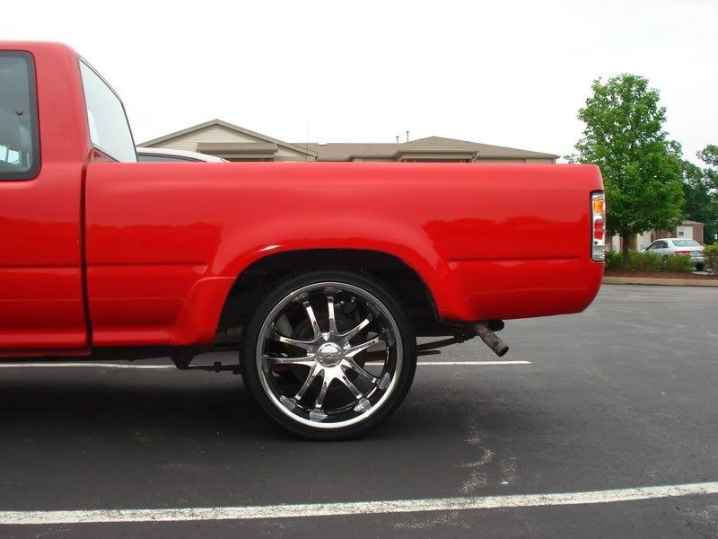

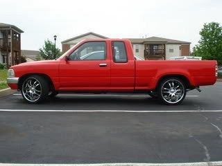

the 20's I got for my buddys taco were 20x7.5 + 45 and there was not much room for those

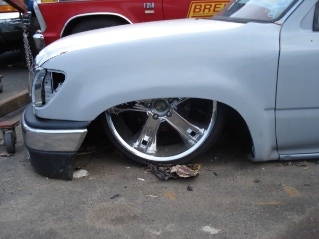

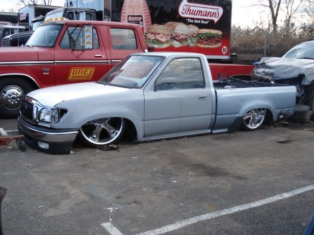

Same exact rims and the truck lays full body all the way around and can turn lock to lock with the truck layed all the way out. All he had to do was section out some of the top of the inside fender. Overall they fit great.

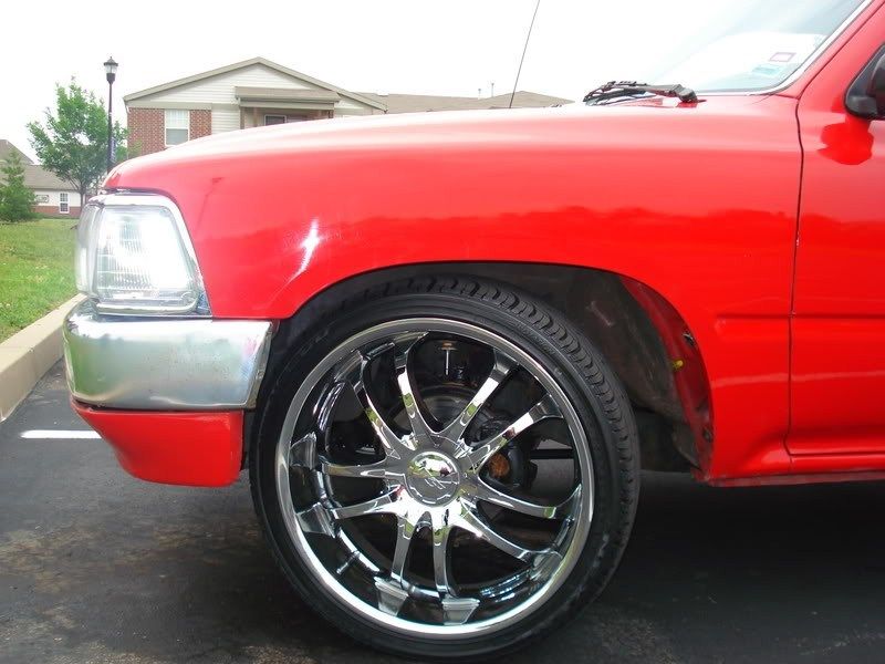

I run an 20X8.5 Bonspeed and a 40mm offset. The front are kinda sucked in but the rear are pretty flush. I wouldn't run much less than a 40. I could see a problem with the bedsides with the wheel all the way layed out.
