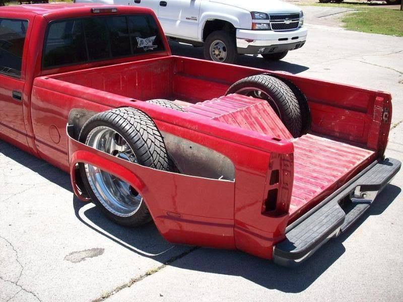

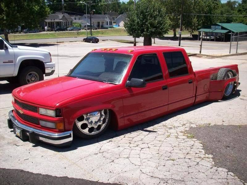

AND if you you it right you end up with this.
man it felt good postin pics of my baby. think i wil find more pics and just post them LOL

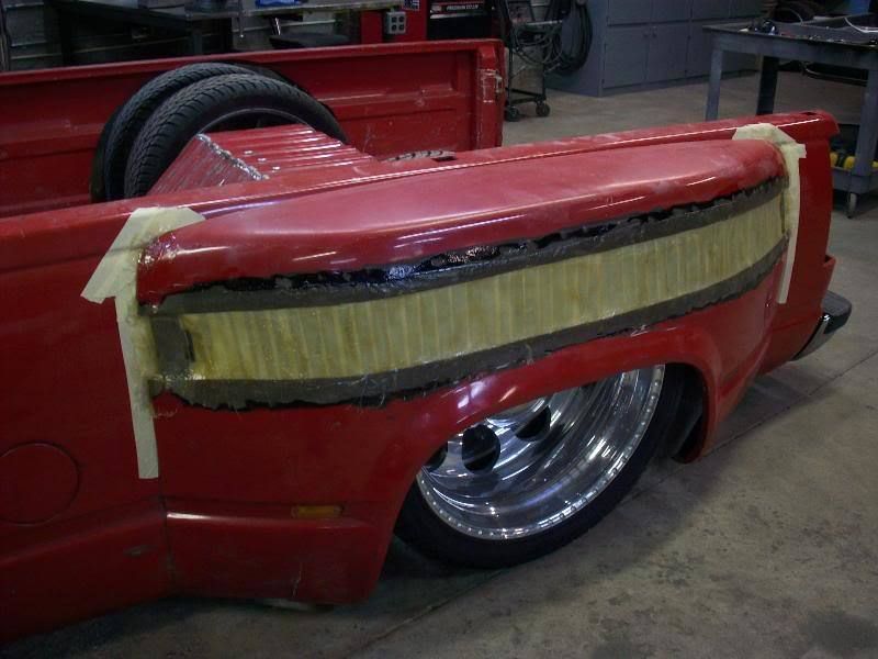

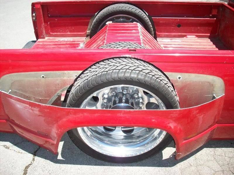

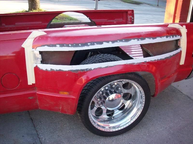

tofnlows10

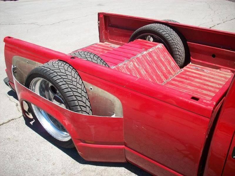

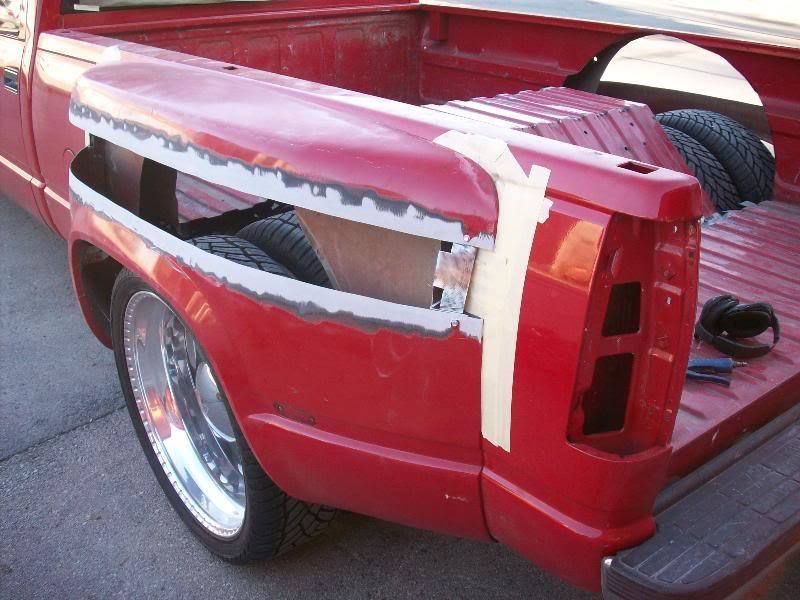

how do u bolt them back on once there done (the tops)? just drill new
holes?
liljlowrider's avatar
liljlowrider
the top holes are the same (there arent raised) you just have to redrill the side holes. mine are 4 inches longer. so holes are two inches drilled two inches farther out on each side.
