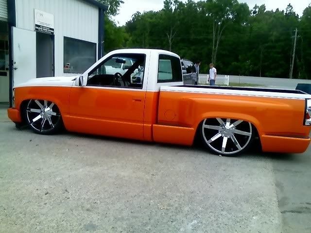

here is a pic of my buddys 93 on 24s with the small tires that tire looks scarey

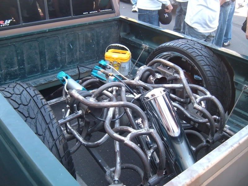

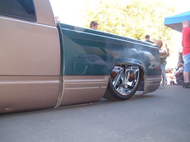

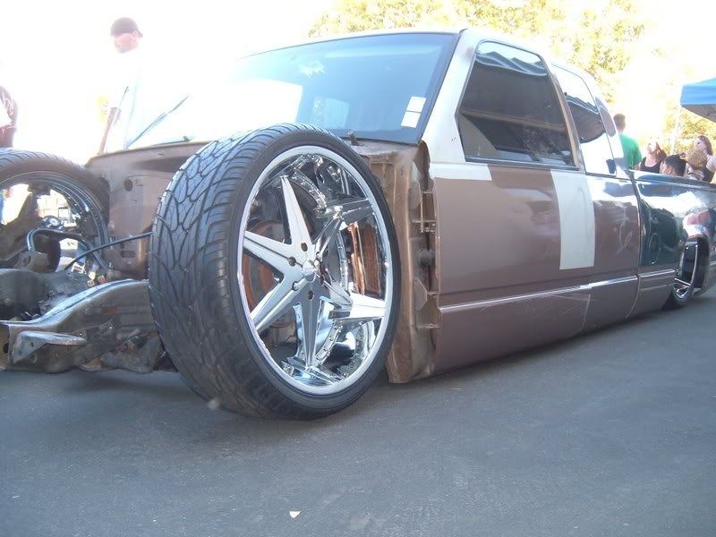

HERES STEVE'S CHEVY FROM SAC, HE'S ON 26" BIG HOMIES!!!!

That truck is sick, I love those KMC slides, badass ride

THis backhalf reminds me of one of those pictures with all the color youre spose to stare at for an hour to figure out whats really in the picture....not hatin...im jsut confuzed on how it works can ya fill me in?thanks and it looks sickk by the way.

Does this guy have a profile on here? Or anyone know of where I can see some more pics of it?

what is the two offsets on this truck?

I've seen it. You have to look at it for a second to see how it really works. The bags push forward on a lot of that tube work, which is connected to a bushing at the back of the frame to pivot on, and the other end of that pivot pushes down on the lower link bar. Its a cool idea, but poorly executed. The u-bolt guides are a nice touch, and the upper bars that have been pie cut 40 times and ground down with a hardstone. Its scary to look at in person. I'm sorry Steve.
